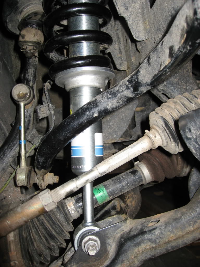

    After a year and hours of research, finally pulled the trigger on a set of Bilstein 5100 shocks and new Goodyear Duratrac tires. Below are my thoughts:
    Bili 5100's: Set at 1.75, which levels the truck perfect w/ the rear TSB. Truck rides great and thankfully no noticeable vibration. A friend did the install and it went well, except the we installed the bottom plate upside down, which gave us an added 1" but made it very difficult to compress and set at 1.75. At that point I figured something was wrong and went to the forumns for answers - mission accomplished.

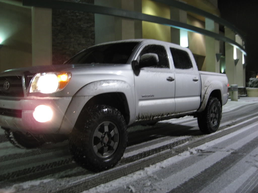

    Tires: New Goodyear Duratrac's - 265/75/16". One word....AMAZING. Purchased at Discount Tire in Reno. The day I had them installed, the snow started falling. These tires have excellent traction in the white stuff. They also transformed the look of the truck. Very, very happy.

    Below are some photos - truck is dirty as I've been on the mountain all week enjoying 5+ feet of new snow. **NOTE** - The photo of the suspension shows the WRONG WAY to install the shocks - the perch is upside down.

    Yes, sorry should have noted that in the photo. We did install the correct way.

    Yes, he says it has already been rectified, good thing too....

    good catch!

    Nice truck good setup. I've got the 5100,s also. And, thanks to your picture, I realized that I have the perch up side down (apparently like my brain). Its been wrong since day one. This past October. Thanks for posting.

    nice...i been hearing about people installing the bottom plate upside down....lol...glad you got it figured out....thanx for the pic...now i know to turn it the other way when i get mine put on :)
