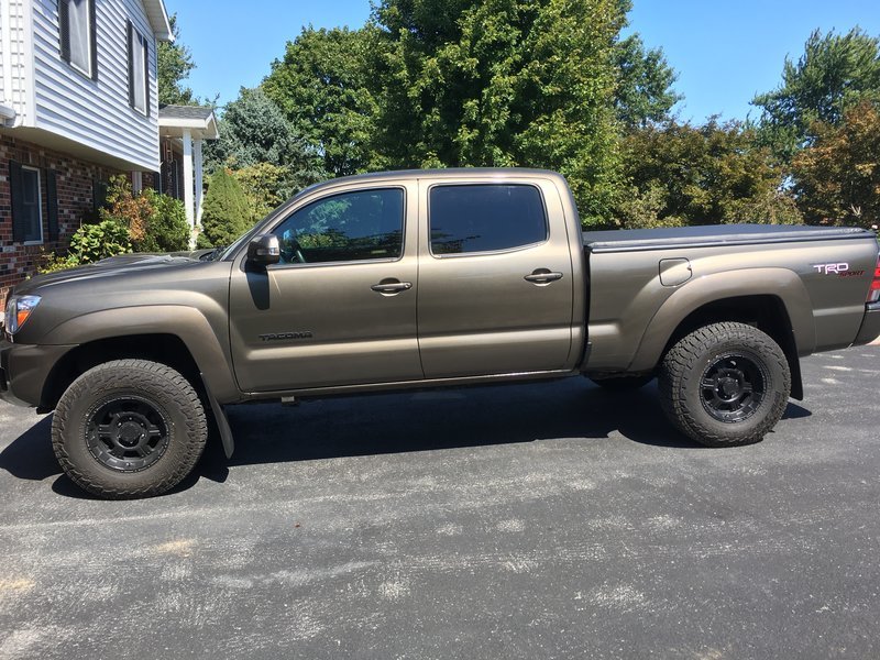

    I have the 4 leaf factory pack. 1.75" on the billies would have made mine nose high. I have 1.5" icons in the rear now and have a slight rake with 1.75" up front.
    This is on a hill, but you can see the rear gap is just slightly bigger than the front.

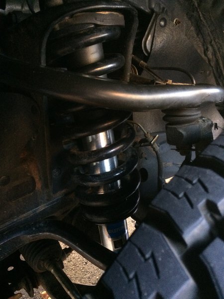

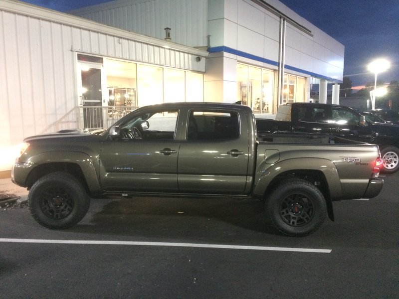

    Here is the after photos- again, 2012 DCSB TRD Sport with factory 4 leaf pack. Installed Bilstein 5100s at the .85 setting and a 1/4in polyurethane strut top plate spacer. Before the install, rear was about 1.75-2 inches higher than the front. After, the rear is 1/4 inch higher than the front.
    Before:
    After:
    At the shop
    Close up of front bilsteins
    I'll be glad to answer and questions!
