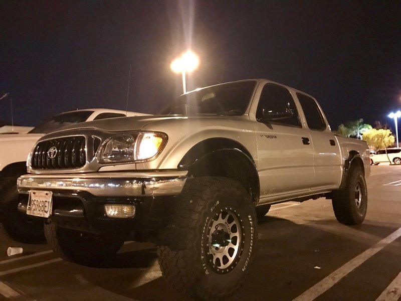

    Awesome! Looks great too. Did you get any lift from it?

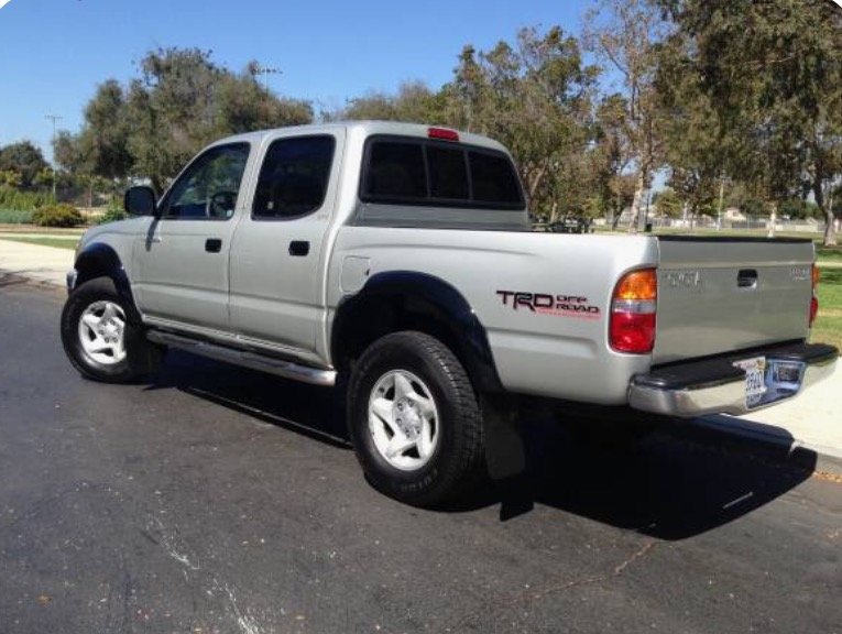

    Yup! This is what the truck looks like with out the lift. I have zero complaints. Easy to do. Did them myself

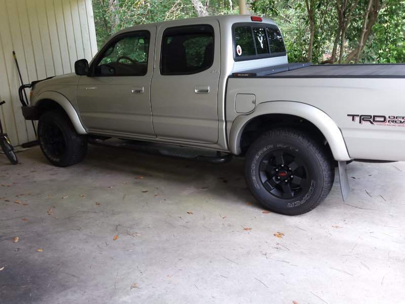

    I had 5100's put on, set to 2nd setting so it rides level, then put an ARB bumper on later. I never changed the stock springs but didn't seem to affect ride height any.
