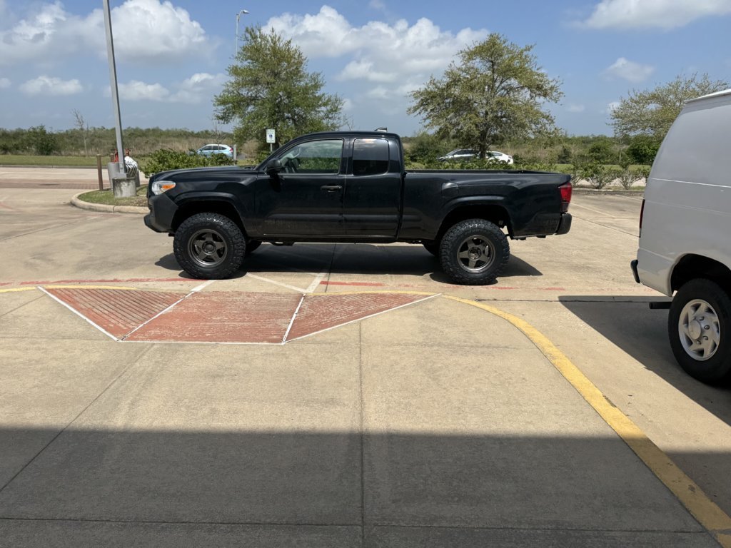

    I did 5100’s (Access Cab) but used the headstrong AAL. They did suggest the 24-186728 with it. It’s worked well.
    The rear shocks don’t have the circlip perch like the fronts so they don’t give any lift.
    A ratchet wrench for the nut on the top of the front shocks were helpful. Offhand I think it was 18mm and the cheaper HF set stopped at 17mm. Was worth it for me to by the next set up that had the 18mm.
    Plan to get an alignment after. Decide if you are going to use the spring compressor route or use the floor jack to relative the pressure (what I did). Look around on here for the difference, plenty of posts on it.
