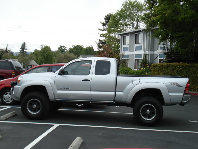

    this is 5100's with 885 OME springs, 285/75/16 BFG A/T's, and OME Dakar 2.75" leaf pack
    I have 265/70/16 M/T's now but don't have a good recent picture, Still looks good, no rubbing on the frame or LCA's.
    I forgot, my truck is a prerunner, with Dr/Icon's set at 2" with a .5" top plate, bilstein 5150's, Camburge UCA's, and still have the OME dakars.

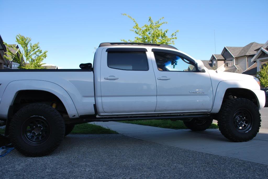

    ProComp Stage 2 6" lift, AAL, Heated Mirrors, DVD/NAV, Amp & Subs, Fog Light Mod, Rear Diff breather. WeatherTech Mats, Soft Tonneau Cover, 33" TrXus M/T, M8000 Winch & Bumper, CB, Rock/suspension Lighting and a whole lot more Soon to come rear Locker and more....
    I'm running OME 886/N140 and AAL+N182 (3" lift) in the rear with 33x12.50x17 (so 285/70/17) M/T's and 1" spacers on the tires (2" lift) . Still running stock UCA's and perfect alignment. 10K since all the stuff was put on
    Wheels have even wear all around, no pulling, and drives great lots of clearance and no probs on any road i've tackled to date.

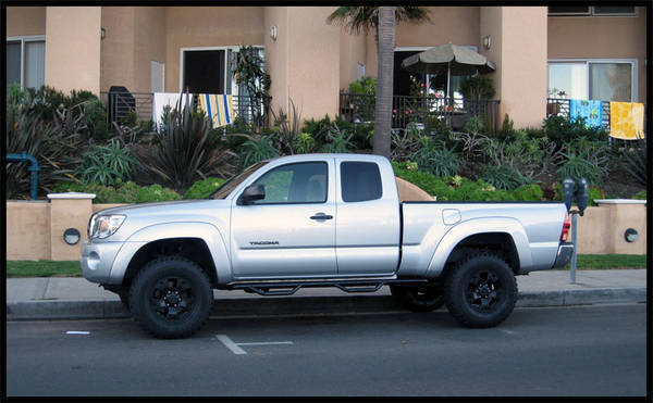

    Front 5100's @2.5", Rear 5125's with AAL. Light Racing UCA's, Factory hood deflector, Sirius Sportster 5, TRD air filter, Weathertech's f&r, "Hello Kitty" steering wheel cover.
    Tom,just as a point of reference,here's my truck with Billy's set to 2.5,and my wheels powdercoated.Next to it is my fathers bone stock....Congrats on the impending return of your Son,and I'm sure he's going to love his new truck.
