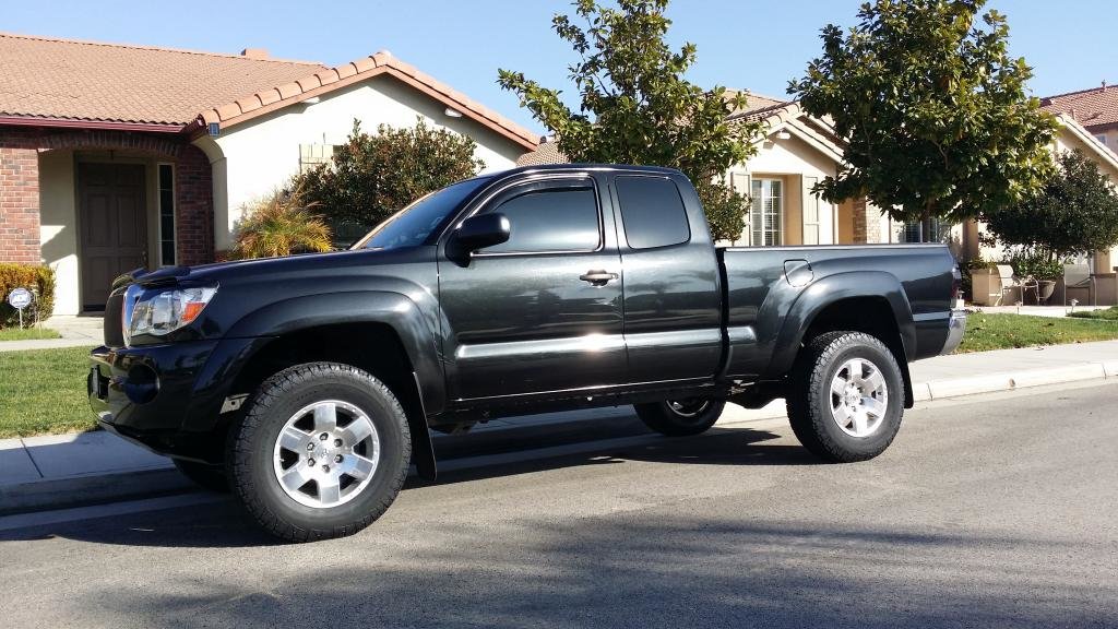

    265/70/17 BFG RT's, FJ 17" rims with 1.25" spidertraxx Debadged, HID's, URD short shifter, Bilstein 5100's in the front, TSB and 1" block rear, URD TCAI with maf calibrator, JBL long tubes, DT Y pipe, Gibson exhaust, Walbro 255 fuel pump, Pioneer stereo, Bak flip G2 tonneau, TRD skid plate, MB Quarts all around with dynomat, Viper Alarm with motion sensor
    Here is my truck with stock coils Billy's set at 2.5, rear TSB and a 1" block which probably equals the 1.5" block. Hope this gives you some perspective.

    Looks Great! So really it depends on the truck how much each setting looks like. From what I have read a 2.5 on one truck can look completely different on another truck with the same lift.
