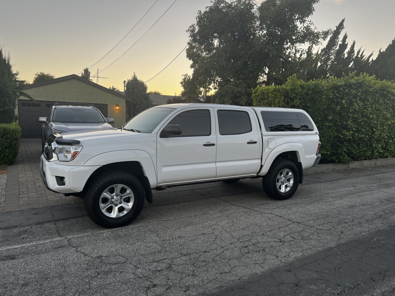

  6. Jul 9, 2023 at 1:51 PM
    E4x4
    E4x4 Active Member
    Dec 27, 2022
    #414042
    31
    2015 TRDOR 6MT
    I just put 5100’s on my 2015 OR. I set the fronts up to .85. Rode the same as stock hight. Get it aligned after
  7. Jul 9, 2023 at 4:11 PM
    GREENBIRD56
    GREENBIRD56 Well-Known Member
    Aug 19, 2014
    #136508
    754
    Steve
    Casper / Tucson
    014 Taco 4Dr 4wd
    I haven't installed the 5100's (yet) in my 2014 but I'm thinking they need to be up a notch. The front springs seem to have settled a bit, especially the driver side. I put a spacer in that side a year ago to square things up - which worked OK - but when I look at it, it doesn't seem to be as high as the photo of E4x4's outfit.
