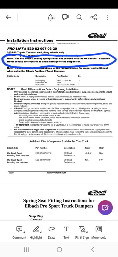

    Eibach for sure, and maybe OME explicitly state if adding a lift spring, you must replace the shock with one that has more travel than stock.

    That's interesting, but what does "extended travel" mean? AFAIK, it has no definition. Tinkerer's Adventure has a good video on the actual lengths of OEM replacement shocks. Some not labeled "extended travel" are actually just as long or longer than those that are labeled that way. King dropped the "extended travel" label a while back and only has one length now.
    Since those instructions don't mention actual numbers, I have to take it with a grain of salt. It would be interesting to hear an elaboration from a representative of Eibach.

    Agreed it would be nice if Eibach was more specific. Like how much extra travel needed?

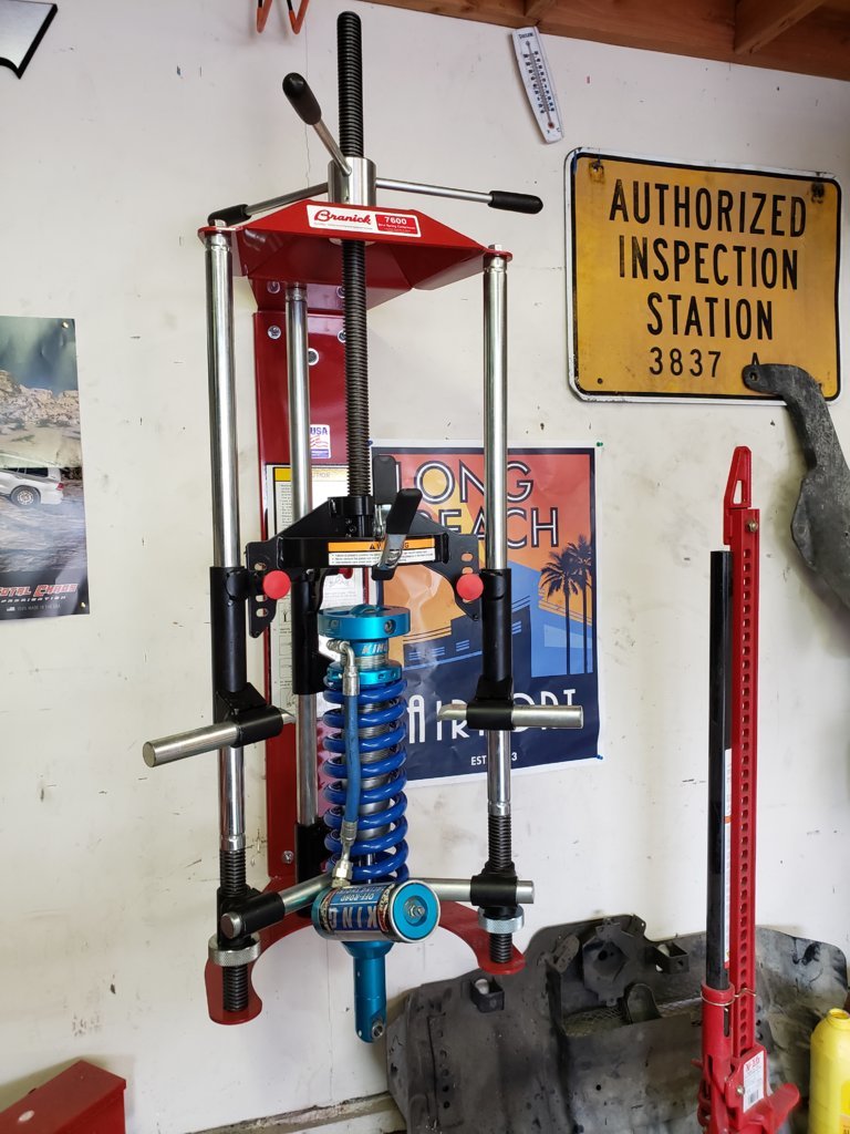

    I install lift kits on Tacomas, 4runners and other Toyota/Lexus almost every weekend. M-F I'm a mechanic at a performance shop that specializes in Toyotas.
    I own a Branick 7600 wall mounted spring compressor. In my home garage. I can tell the stiffness or preload of a spring by how hard I have to crank on the handles.
    Cranking down a stock spring, set at the highest (2.5" lift) 5100 clip position is forcing that spring to do things it was never intended to do. Be squished into a smaller space than designed.
