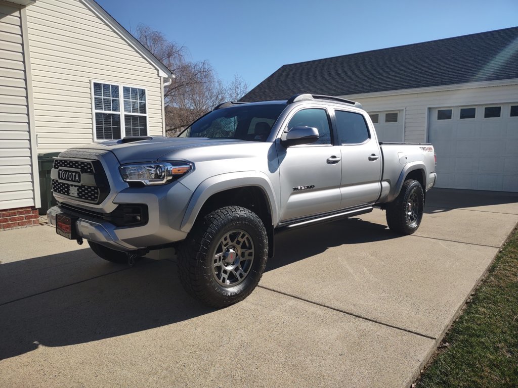

    1000000534.jpg 285s stock springs on the 5th perch! I went up to 285s and raised from the 4th to the 5th perch and no difference in the ride.
