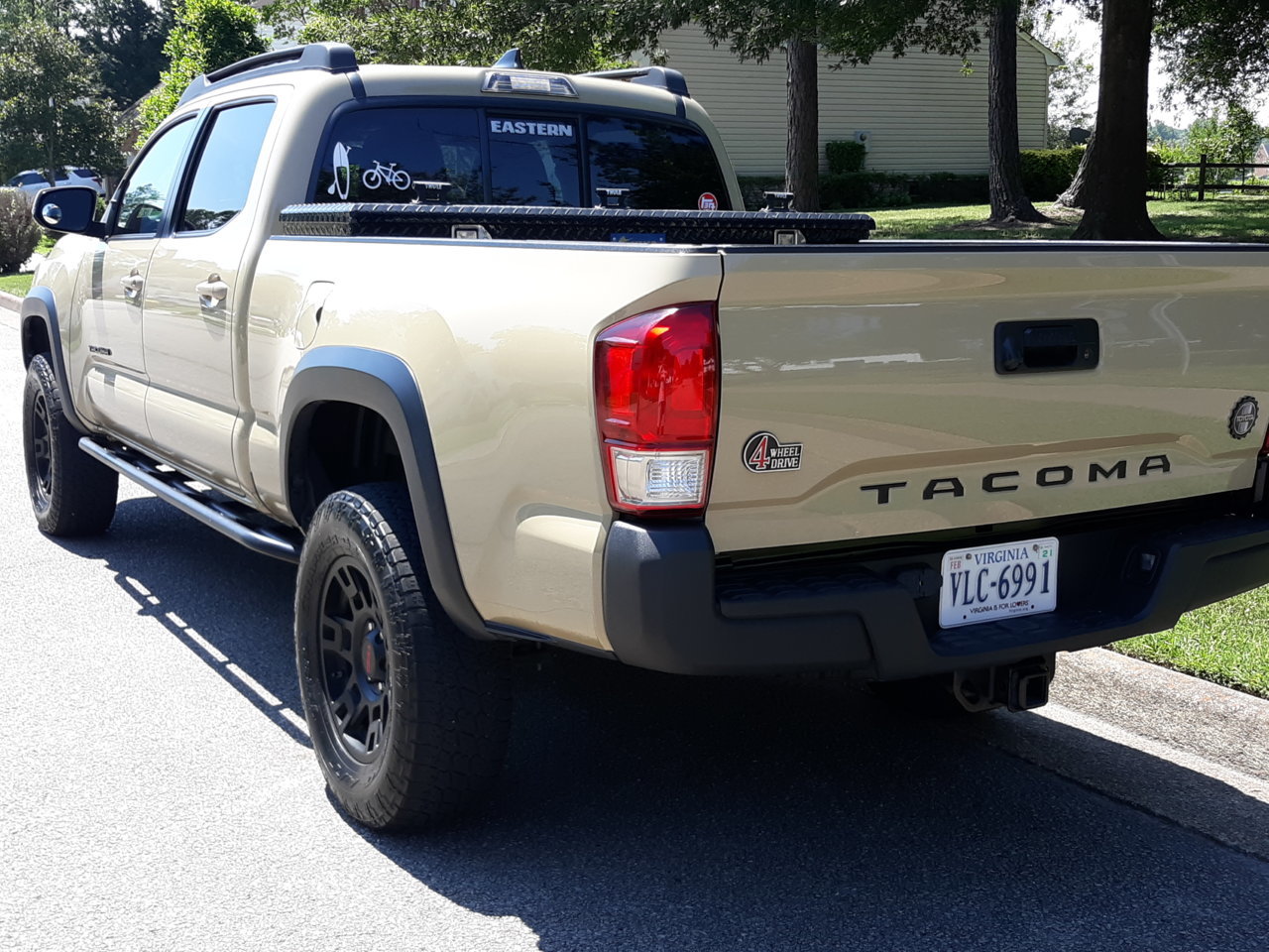

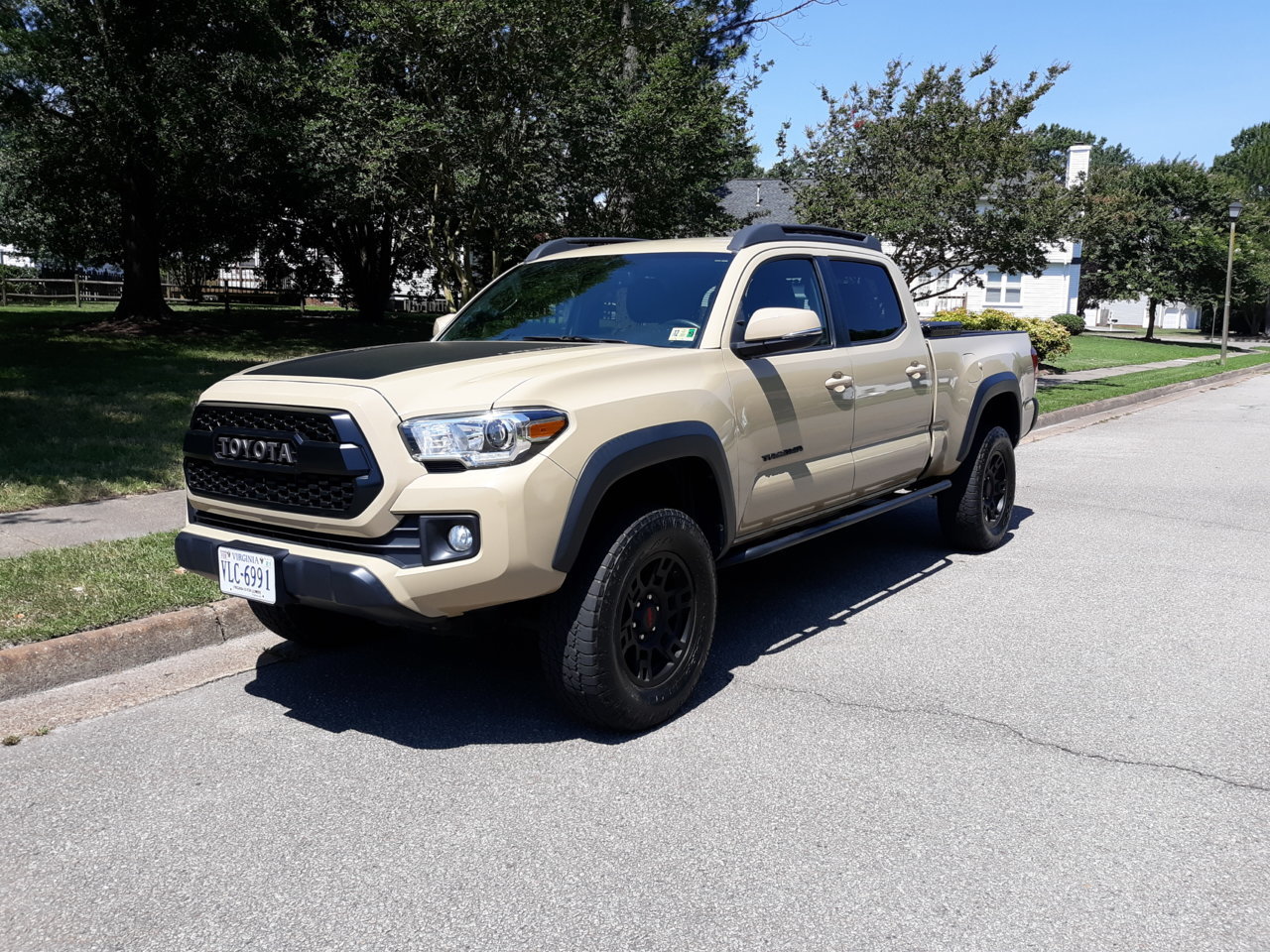

    jsinnard
    jsinnard Well-Known Member
    Feb 4, 2009
    #13279
    6,679
    J
    Virginia
    16 QS DCLB OR 4X4
    This is 887s with a 3 leaf progressive AAL in the rear after a year.
    Still maintains factory rake.
    3 leaf rides better than a single leaf AAL with an empty bed and is only about $160.
    Nose up appearance is due to a slight tilt of the camera.
