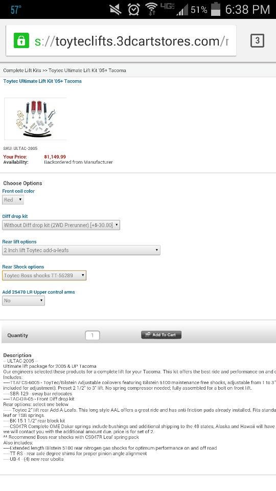

    You might be best set up with an OME lift. Because you would need a very small spacer to reach 2" with the 5100s at 1.75. If you do bilsteins at 0.85 and eibach coils you'll be right at 2.5" of lift. That's the toytec lift kit and I'm not really sure what the toytec boss lift kit is but it's probably worth looking at. As far as cost difference it just depends on all the parts you want for each setup, you would have to compare that on your own. One thing I will tell you is don't get anything temprary, save up for the one you really want or you'll end up paying more to swap it out. A lot of people do that

    Like this combo?

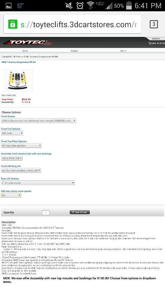

    Or the ome5a3b1c8cd981a76474a462d37e7e9a3d_4aad40f34703396741076d09b6d2c143b45148a3.jpg
    Or this one

    What these guys said. I have never seen an appeal from those full sets, seem overpriced... I would get either 5100s and eibachs or nitro9000s (OME shocks) and 88- series coils. The one benefit from the full set is they come in preassembled, just unbolt, swap, bolt. I had to get mine assembled at a shop and though they did it right, I would much rather have had them shipped to me correctly.
    You will have a much nicer ride using OME shocks and coils because for one, the eibachs are stiff enough as it is, and preloading the 5100s to 0.85 will make them stiffer. Meanwhile you have a handful of OME options (883,884,885,886,887) that require no preload.
