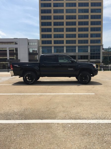

    Here's a pic if you're interested

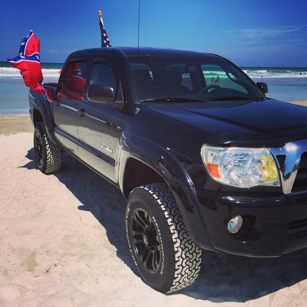

    Nice looking truck bro got a side profile pic? I like that your supporting your southern pride man

    Yeah I have one, but it's not the greatest. Here it is, but I'll go take another one right now. Be right back

    Well can't get a decent picture cause someone parked right next to me, but I would try the 1.75 setting first. If you want it mostly level with around .5" of difference that would be your best bet. I believe you will maintain some factory rake, so hauling or towing shouldn't be too big of an issue. @PeeRunner is correct about the coils. Coil lifts are the best way, but I'm happy with the billies set at .85.
