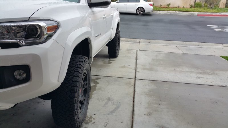

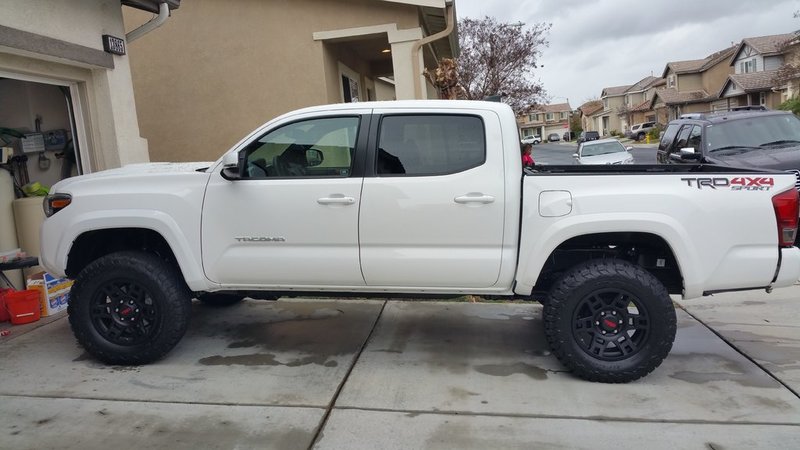

    At 1.75 I was able to achieve 0 toe .7 camber and 2.1 caster. That is the closest they could get to what I wanted which was 0 toe, 0camber and 2.5 caster. The camber is considered acceptable so I am hoping I dont have strange tire wear but will keep my eye on them.
    Alignment discussed above. The ride is great I have zero complaints. The suspension barely made the front end a little stiffer but it's very minimal and I think it is perfect as it seemed a little spongy stock. The rear blocks with 5100 shocks didn't change the ride in the rear at all that I noticed. See pictures below with the rear 1-inch blocks. It is slightly higher in the rear but barely noticeable on flat ground. I like the slight rake as it gets better mileage and the rear bumper is the most vulnerable off-road. I am completely happy with how the truck turned out.

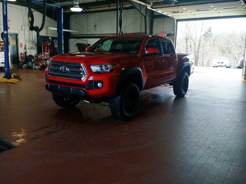

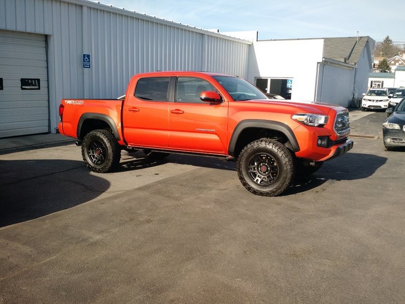

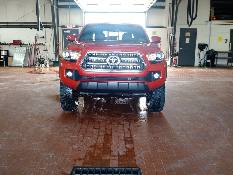

    Finally got mine on a couple days ago but didn't get pics until after I washed it today. I went with the 1.75 setting on the front, and a 1 inch lift in the rear. I'm running 275/70R17 KO2s on TRD Pro 4Runner wheels. I know it's hard to tell in the pictures, but the wheels push the tires dead even with the flares when looking from the front and back. I'm really really liking this setup
    Oh yeah... Inferno FTMFW
