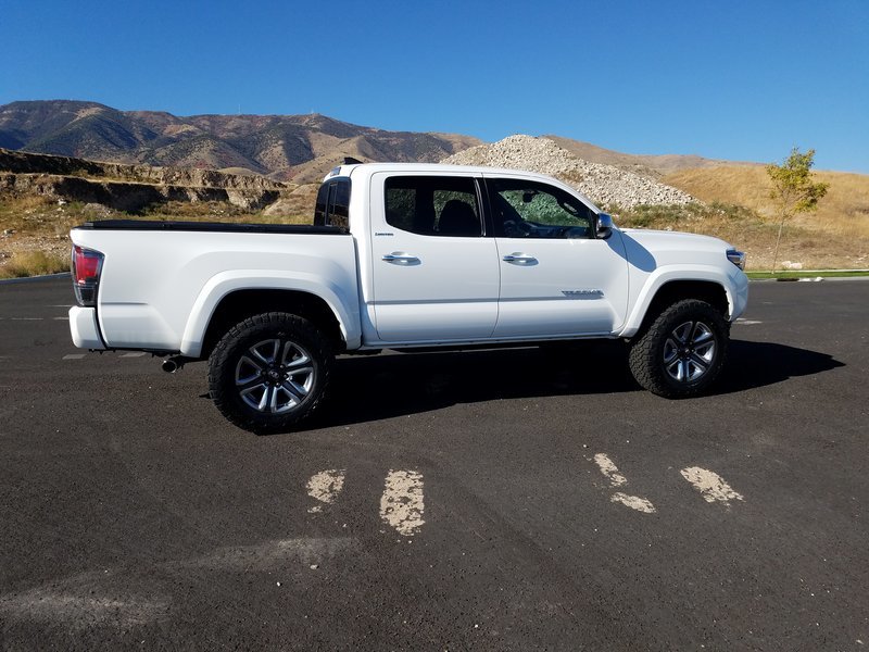

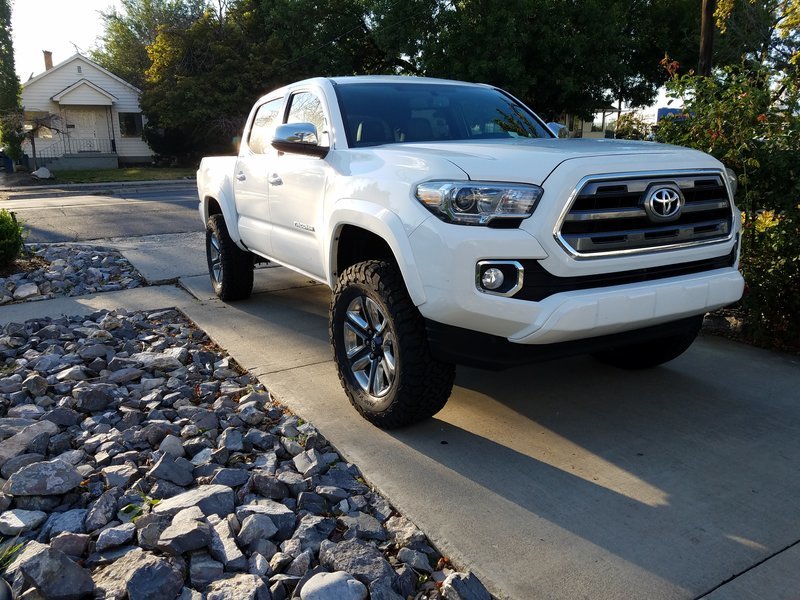

    Looks good. Any side shots?

    Here is some side shots.
