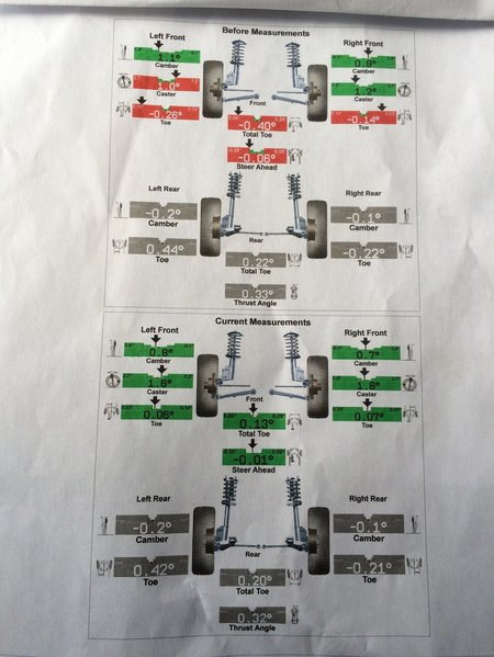

    I guess when I take my truck for alignment that will make me belive. Meanwhile I'll search for those alignment sheats

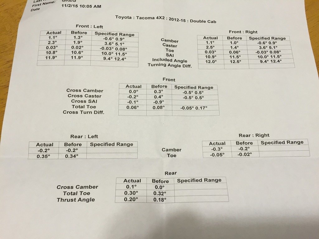

    I posted the below spec sheet on pg. 2 of this thread. States 2012-15, but it's for my 2016. My front lift is at 1.75. I will need UCAs as my camber is tweaked as far as it can go and I'm still at a positive setting. I'm out of range for both Camber and Caster. You can see it visually. I have no idea how 2.5-3" lifts are getting away without needing UCAs.

    Yours is the only one I found for 2016. There is another member here that posted his alignment sheet with toytec coil, preload spacer and top spacer around 3" lift and was able to get within spes. Can't find that tread:mad:

    The one that dean posted caster specified range is 3.6 -5.1 he set at 2.5 out of spec, they did use 2015 specs for 2016 alignment.
    The one I posted is caster range 1.2 - 2.7 and it 1.8 within the spec. Question is did they use wrong spec one othe alignments or spec range have changed on 2016
