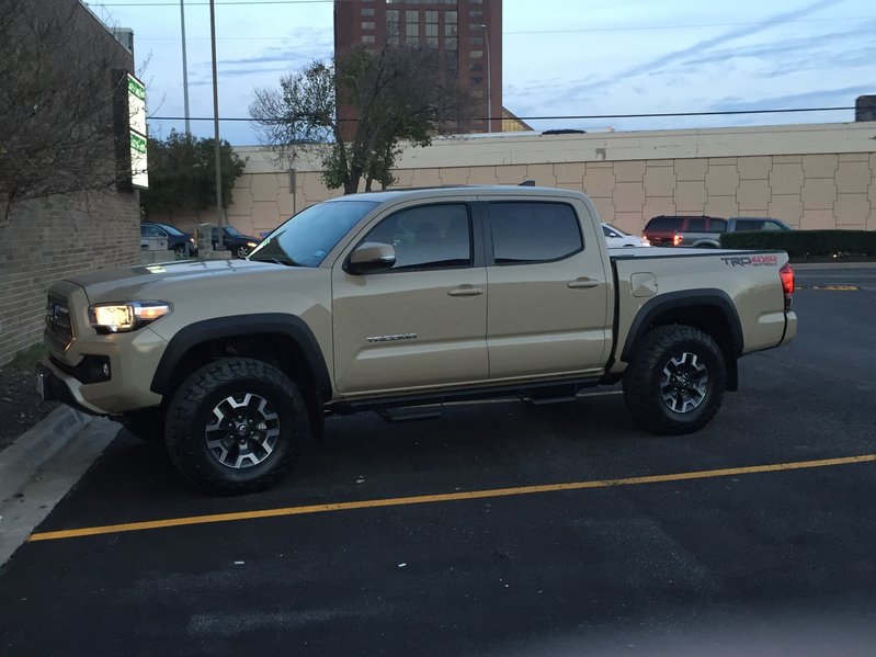

    Mason04
    Mason04 Well-Known Member
    Jul 19, 2011
    #60177
    235
    Texas
    18 TRD OR 4x4, 17 4runner TRD OR 4x4, 75 FJ40, 94 4x4
    Lousy pic but here is my truck with 5100's on all four corners with front set at.85 Tires are BFG KO2's size 265/75/16image.jpg

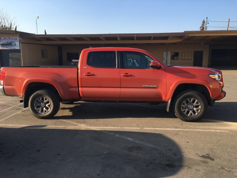

    fonzy
    fonzy Well-Known Member
    Nov 25, 2015
    #170672
    57
    Fonzy
    Madera, CA
    2016 Tacoma SR5 4x4
    None
    E872B76B-BA69-438B-B559-8A9884081740_zps_761d87f43b562fa1593daca1357d74756f2241de.jpg
    DD9CF196-0822-4A5E-9A7C-FC3854223DD6_zps_3d37755ff8bb8af0f76cabd08660949c7e7542aa.jpg
    The ride was not affected. I honestly cannot tell the difference between the .85 lift and stock as far as ride comfort. I was worried the ride would be harsh, firm, uncomfortable but no, it feels just like stock.
