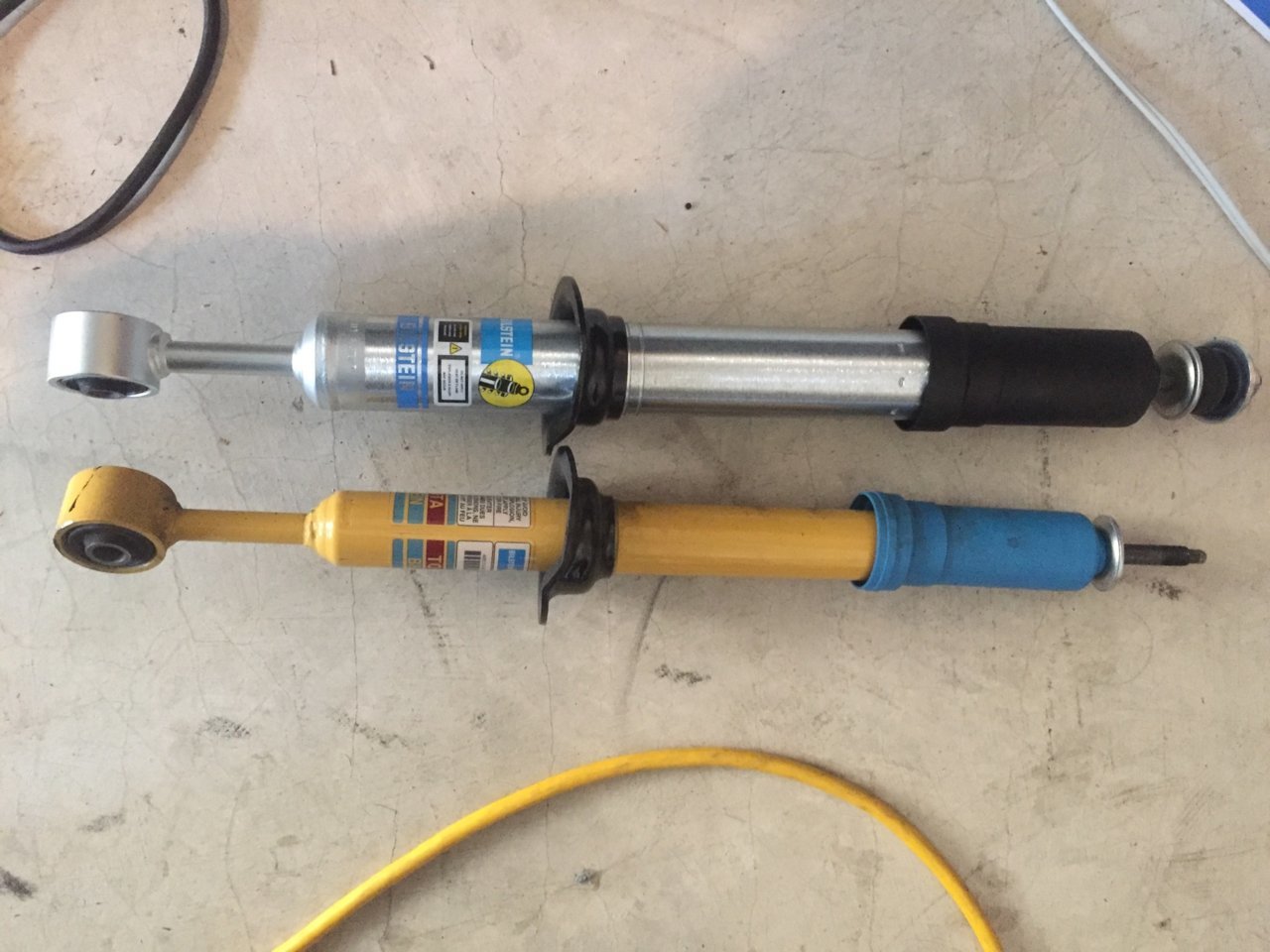

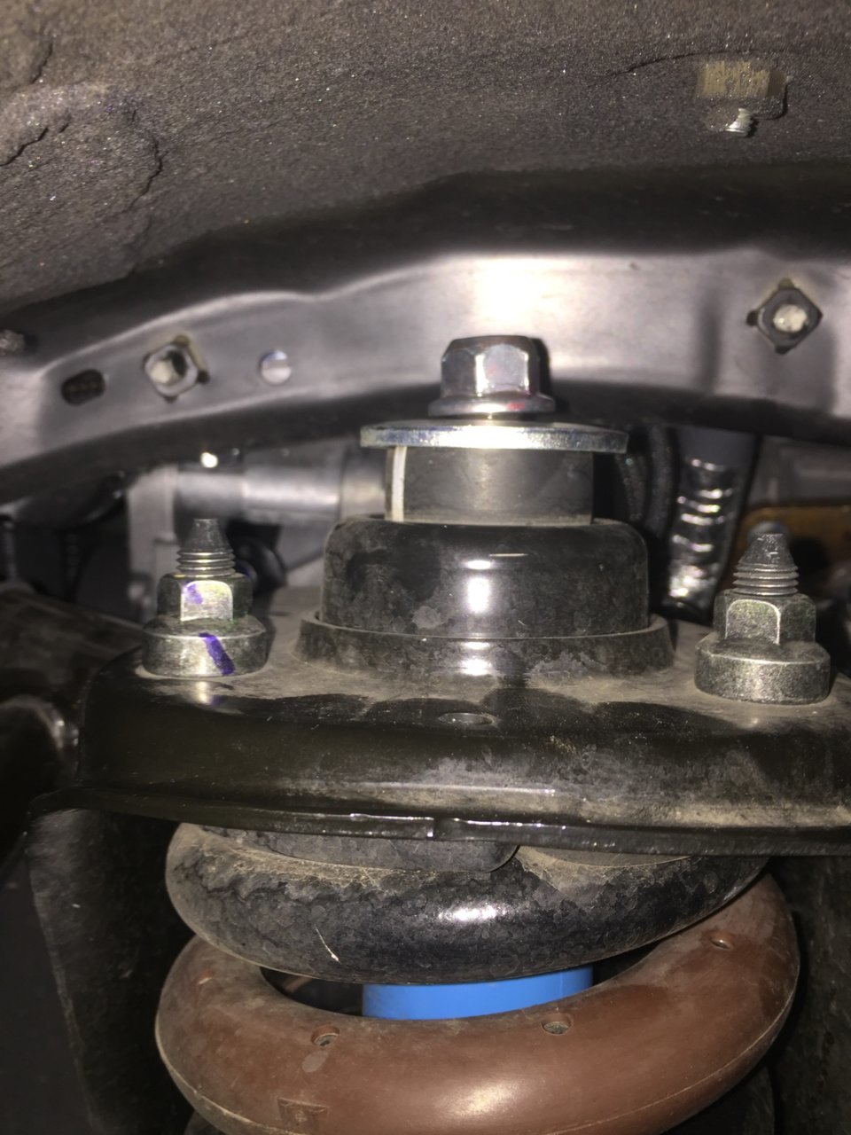

    You don’t need spring clamps or compressors to install new shocks.
    Detach the front sway bar linkage.
    If you have jack stands and floor jacks, you can easily install the 5100s by using the weight of the vehicle by placing the loose spring over the shock, mounting the bottom of the shock on the lower control arm, jacking up the lower control arm while guiding the top of the shock up into the upper mount and then attaching the top nut.
    Then take it in for an alignment.
    I not a mechanic. I watched a video of a mechanic who thoroughly listed all of the tools you need and then safely demonstrated the installation of the coil over without compressors or clamps.
    It’s similar for removal of the coil-over unit. Place a jack under the lower control arm, remove the top nut from the shock and safely lower the coil-over unit downward and away from the top mount. Then remove the bottom of the shock.
