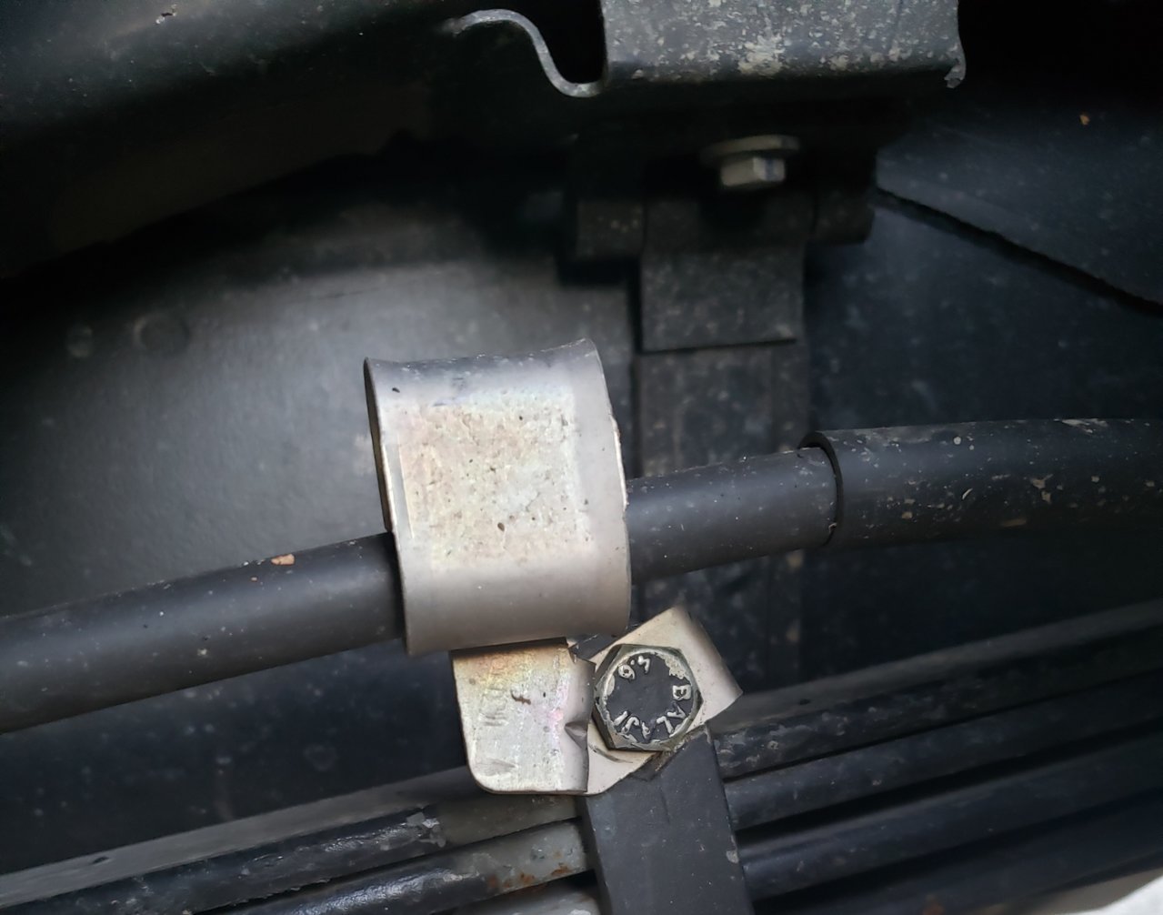

    do you have photos? Any issues off road with brake line length?

    I'm assuming this is what you are talking about? Just drilled the hole larger to fit the AAL bolt and bent the bracket so the line isn't rubbing.

    that’s it! Thanks for the photo!
