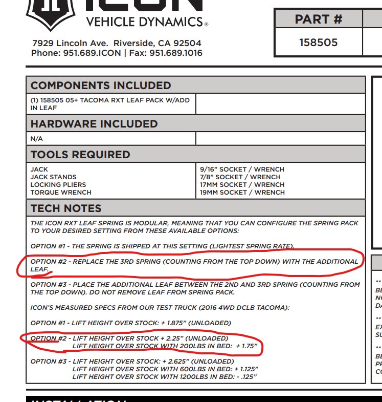

    I installed rear 5100 paired with the stock leafsprings and got no lift at all. It was for leveling with front 5100 at 1.75" setting. Right now im actually looking for a drop-in leaf-pack without blocks that would level with front 5100 at 2.5" setting.

    Right. The rear shock doesn't give any lift. That is done with different springs.
    I used the Icon RTX leaf pack to get my lift in the rear. Option 2 gives me a little bit of rake which is nice for when I add stuff I'm not squatting. I'm on the top perch of the 5100s in the front.

    Oh ok gotcha. So no need for blocks with the Icon RTX leafpacks? Does option1 provide a lift?

    Yes but depends on how much weight you have back there. I have a topper so option 2 made more sense.
