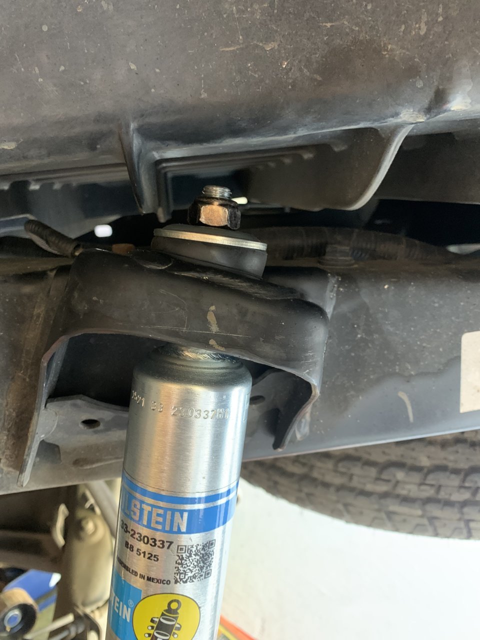

    I installed up front: SPC UCA’s, Bilstein 6112’s on the 5 (highest) notch with new top hats.
    Rear: the RXT leaf pack (new) - and Bilstein 5100(?) shock. I took measurements before I started and I’ll share after it’s all set up.

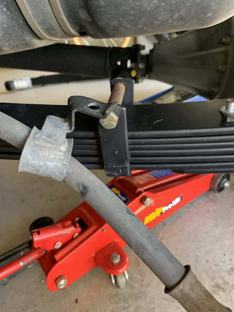

    So I’ve another question. The RXT leaf packs don’t have a hole that I see to hook up the bracket cable to like the OME did. Any suggestions?

    For this I wallowed out the hole on the bracket and attached it to the middle clamp. There were more than enough threads to do this. I think most just cut it off though.
    EDIT: First clamp with the RXT's.

    ThT what I was thinking of doing. Ok thank you again… really appreciate all the feedback

    Sorry, first clamp on the RXT's now that I'm thinking about it.
    I used the middle clamp for my new Deavers.

    Ok finally got one on… thanks all!! Seems one has to “ man-handle” them
