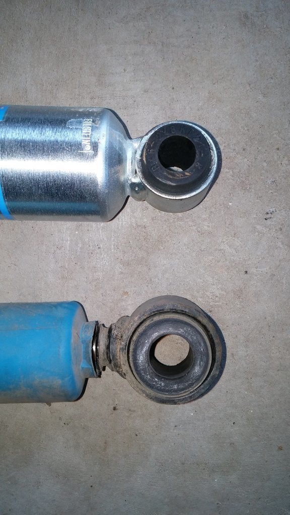

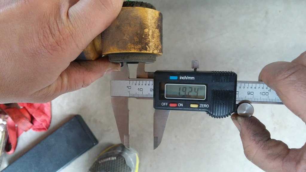

    so, just realized as I have my rear suspension in pieces for my install, that the shocks I ordered, bilstein 5125s, have 16mm bushings, my 1st gen taco has 19mm...
    the way I see it, unless I can find a bushing to fit the 5/8 eye to make it 19mm, I can either
    a.) attempt to drill out the bushing to 19mm
    b.) cut my losses, try to sell these shocks and buy a new set....
    any ideas?
    new on top, old on bottom

    How's the Bushing OD?
    Imagine another option would be to swap bushings?

    Wasn't sure if they made bushings, couldn't find much online last night and I discovered it too late to make any calls.
    Luckily Toytec had them, and luckily I live 30 min from them was able to pic them up and swap them out in about 15 min. Problem solved
    The OD of the bushings was 1.125"
