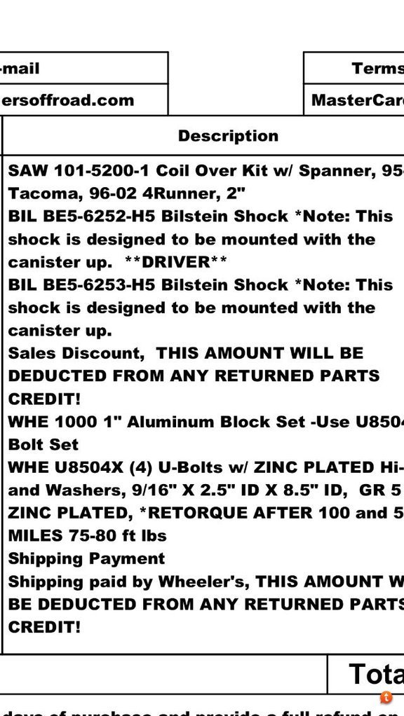

    My old receipt from Wheelers on my old setup states to mount the 5125's with the canister up meaning boots down:
