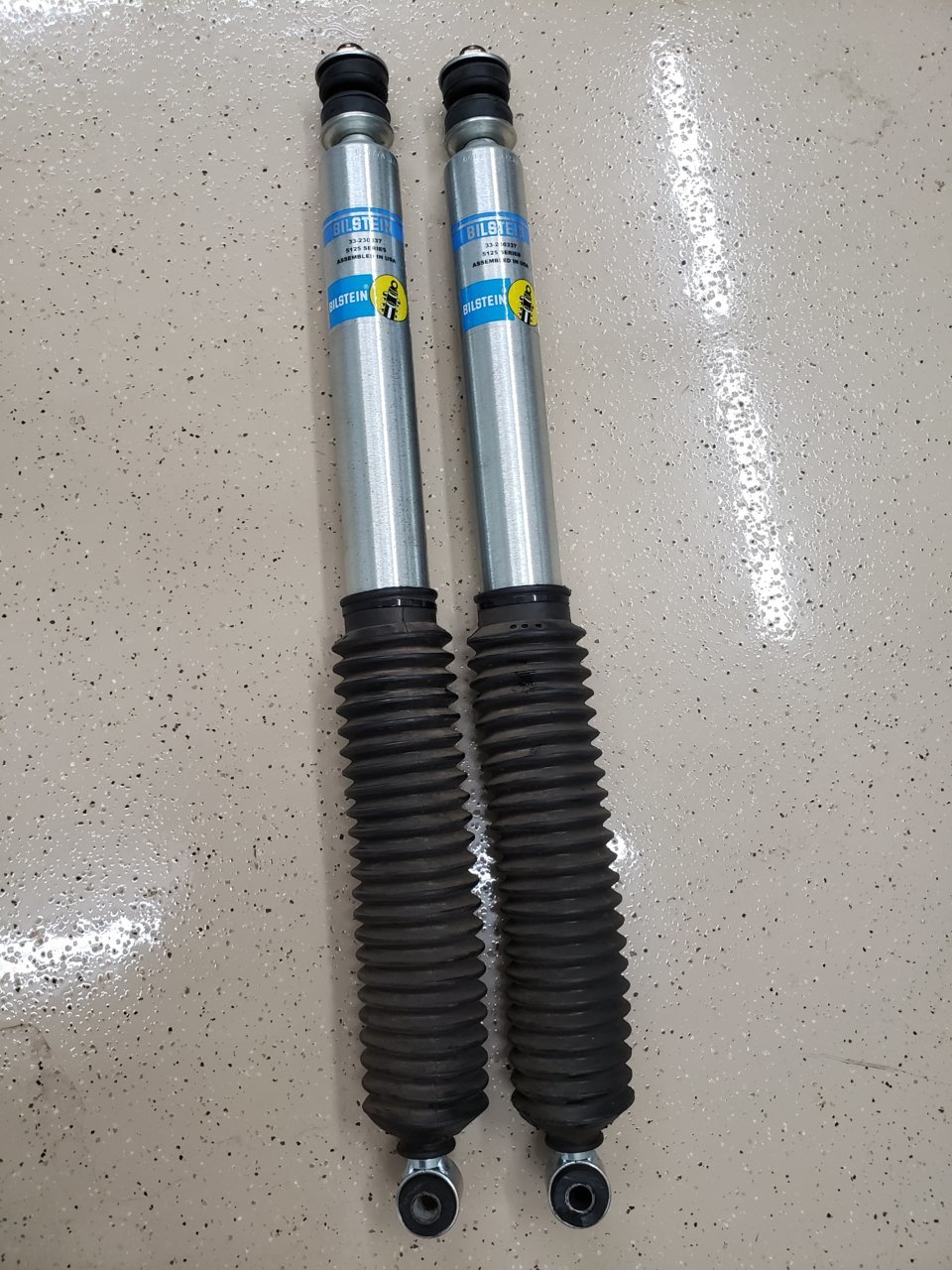

    These would work perfectly for you. They will give you more travel than the standard 5100 without needing to upgrade to longer brake lines. The B110 would require new rear brake lines to utilize maximum travel.
    Bilstein 5125 part number 33-230337. 9.4" travel - 24.40" ext, 15.00" comp. Too bad you are not in Phoenix, I have a set for sale with only 3,800 miles on them.

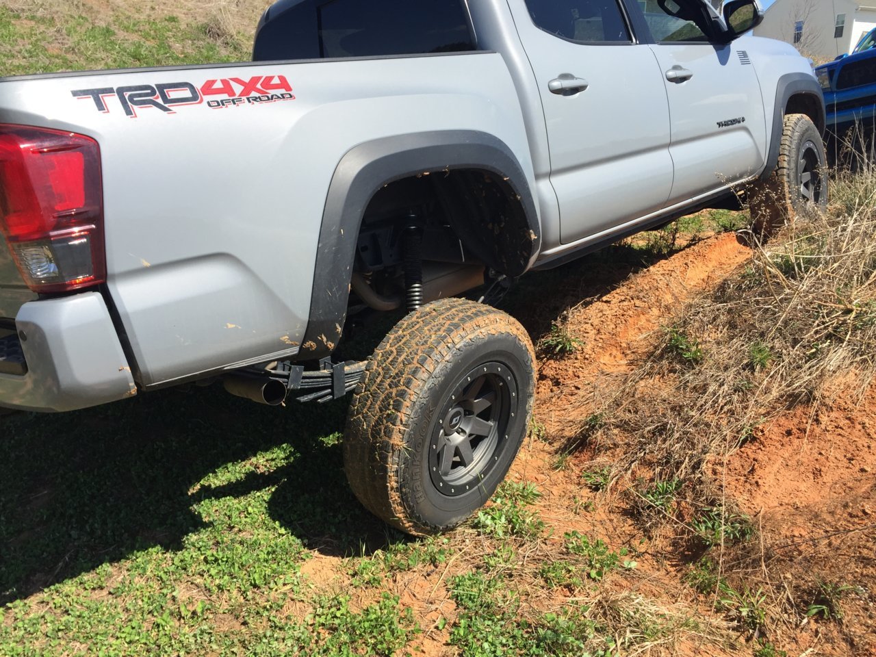

    I did the extended travel 5100’s for the rear and have great travel!
