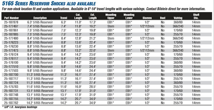

    Ooooo... those are pretty.... but there is only a 14 inch collapsed length with 9.8 travel and the 16.1 which is probably really close but that offers 11.3 inches of travel...
