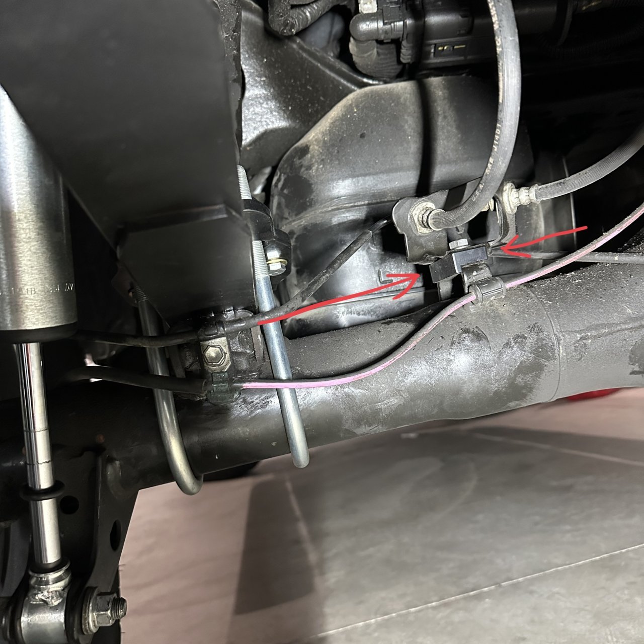

    I just went out in the garage and grabbed a quick pic…the red arrows point to the Bilstein spacer…

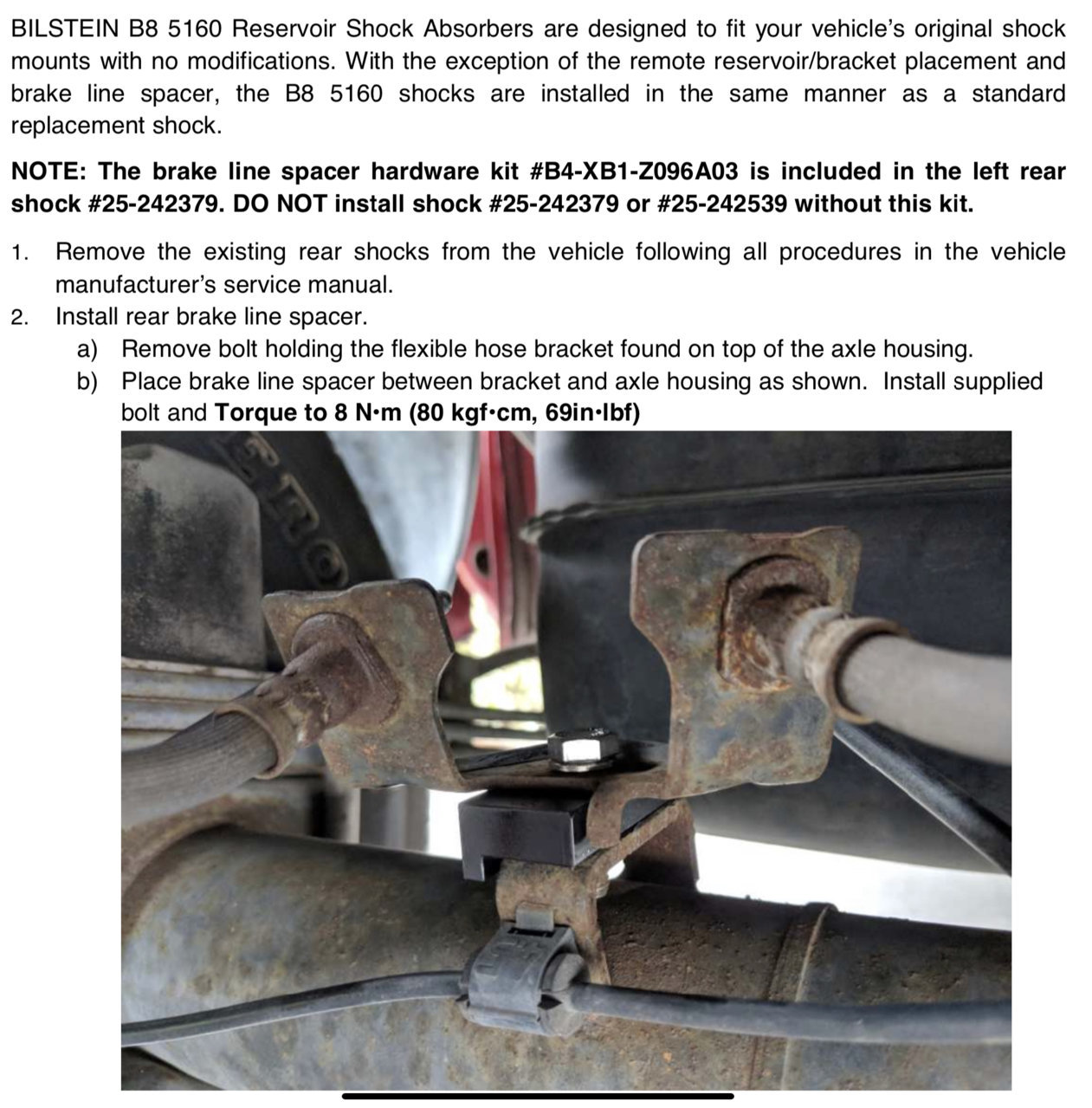

    Edit:
    Decided to post the section from the install guide as well, just for reference to the next poor sap that stumbles across this post…

    I think I do remember that now. What the hell was that about?

    Yeah how are you guys getting that spacer? It doesn’t appear to come with the newer version of the shocks.

    I’m thinking it came with older versions. I’m certain I ended up with older “new” stock shocks.

    Maybe the shock had more up travel?
