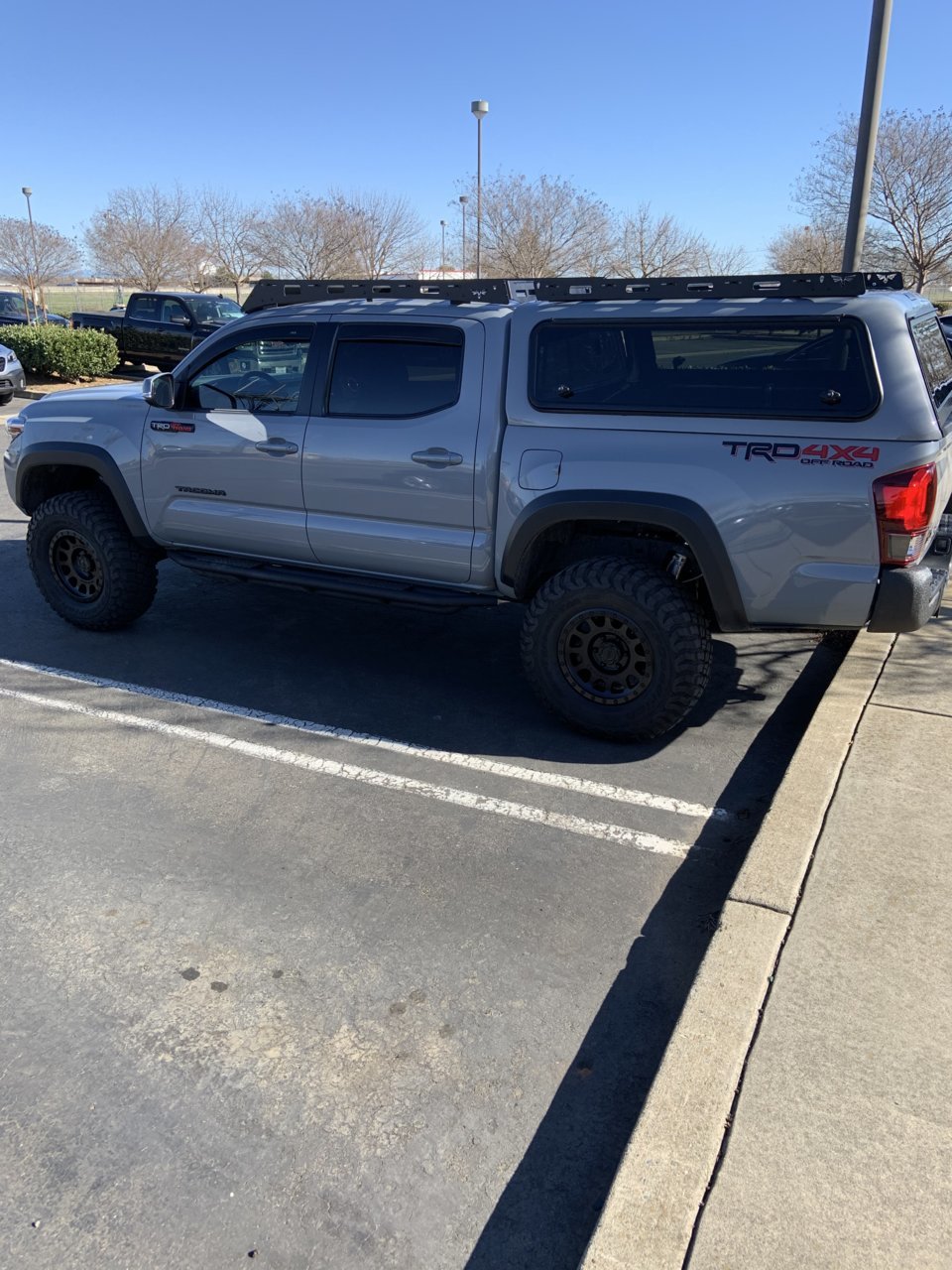

    Here’s a pic for reference. 3 inch rear lift with the HD Dakar’s. 5160s are fine but I wouldn’t want to do anything higher or else you’d destroy the shock off road.
