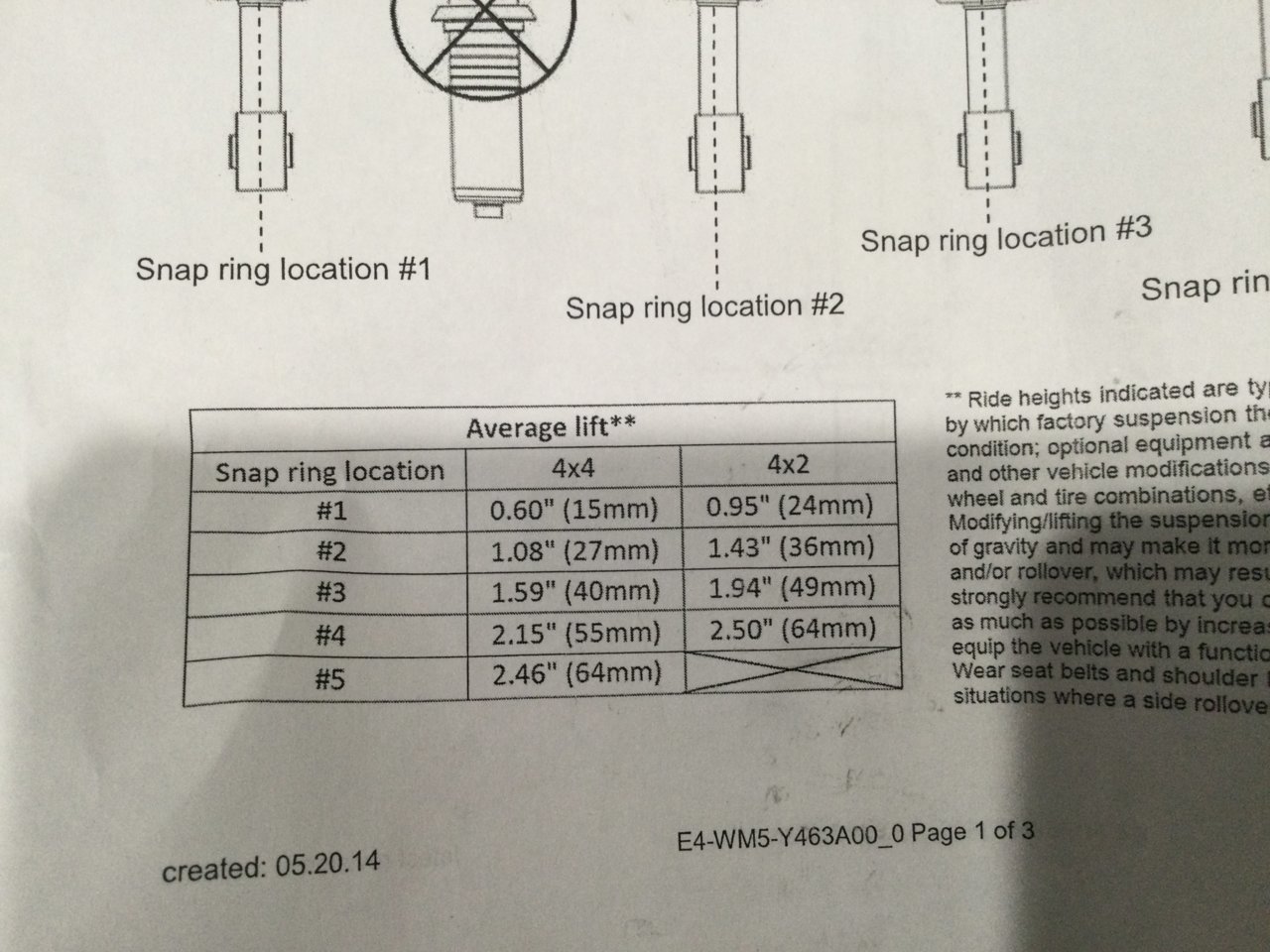

    Here’s the paperwork that comes with the 6112s. Just got mine in today. Had to order locally after cancelling with Wheelers since they kept my money for 5 months with no shipping estimate.

    Sorry, just noticed you asked for difference in ride and not difference in height.

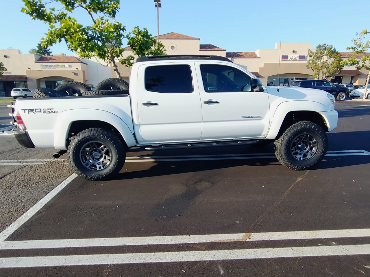

    I have them maxed out, no complaints on ride quality. I only got a 2.5" lift up front after settling.IMG_20210603_184527269.jpg
    I was also one of those people who gave wheelers money for 5 months. Won't be buying from them again.
