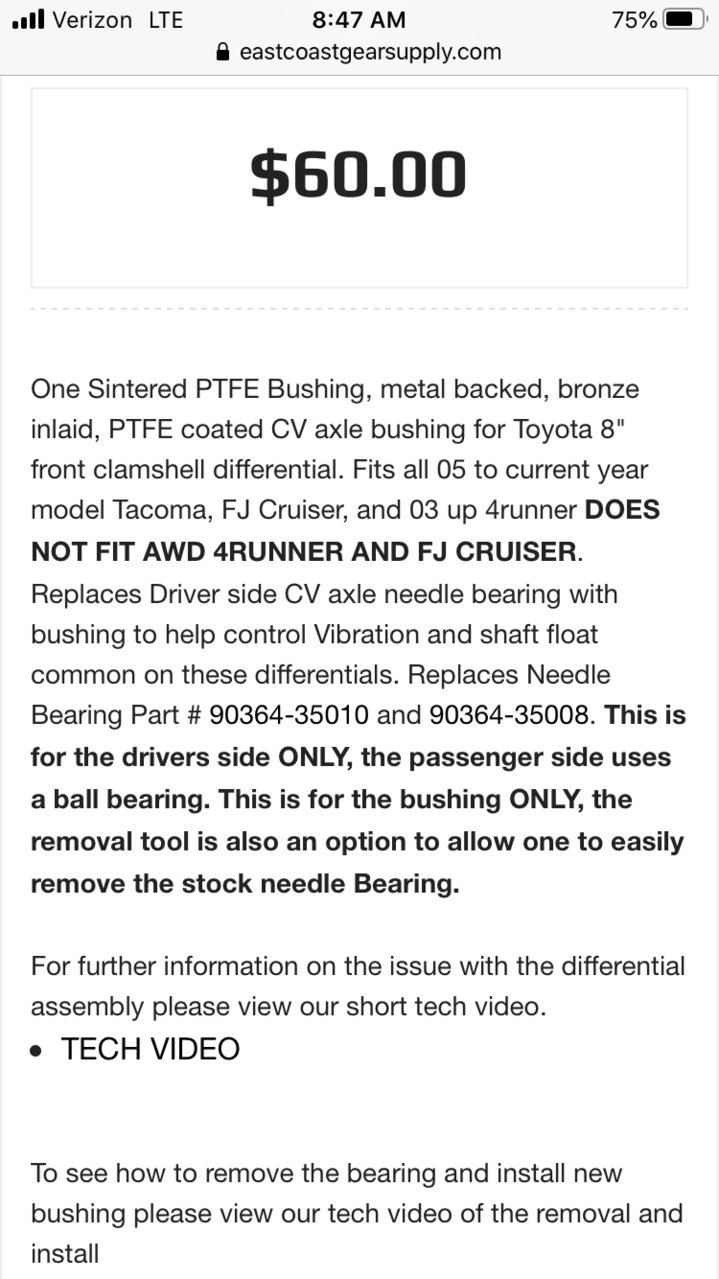

    Lol the ecgs bushing is not for driveline vibes. It is definitely worth doing while you have the truck apart. The bushing is made to replace the OEM needle bearing that fails on every Tacoma and causes vibes. It’s in the front diff where the cv axle goes into it.

    I did the ECGS bushing after noticing a vibration from 20 - 40 MPH. Vibe is gone.....

    I bet every single Tacoma would benefit from it. But people with stock Tacoma’s probably don’t know about it or people associate the vibe to other things. Just my opinion but it’s such a cheap fix, why wouldn’t you do it?

    I followed this tutorial and it went as planned. Download it to your device and bring the device out in the garage to review as you perform the ECGS mod.
