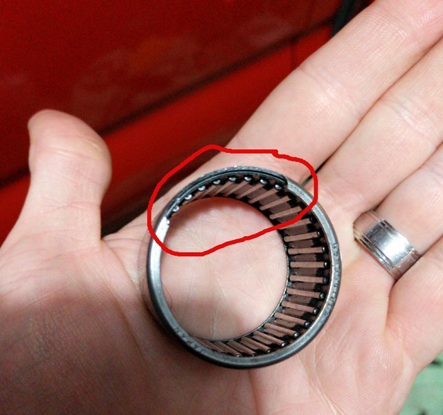

    I HAD to change to ECGS bushing due to vibrations. As soon as you remove the needle bearing, you will understand why it's a great idea to replace it.

    Shitty. Can that happen because of the lift or do you think it broke when you were removing it? Hope you managed to fish out the broken piece too?

    This can happen even without a lift. Some stock trucks have bad vibes, there is a TSB to replace needle bearing.
    That was a photo I found here on TW. But mine did break like that too. Happened upon removal I assume. I stuffed plastic bags into the diff opening, to keep anything from falling in there.
