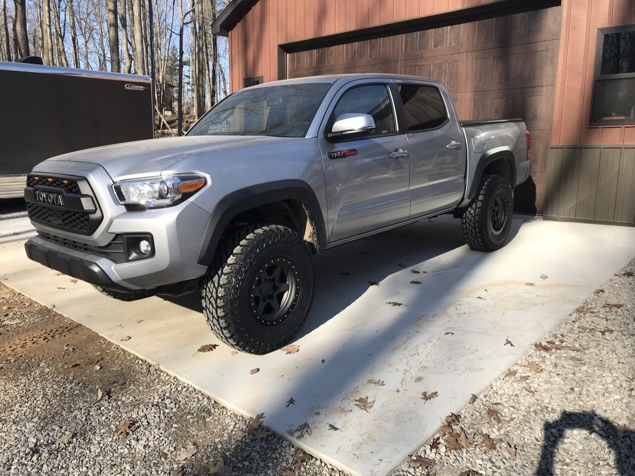

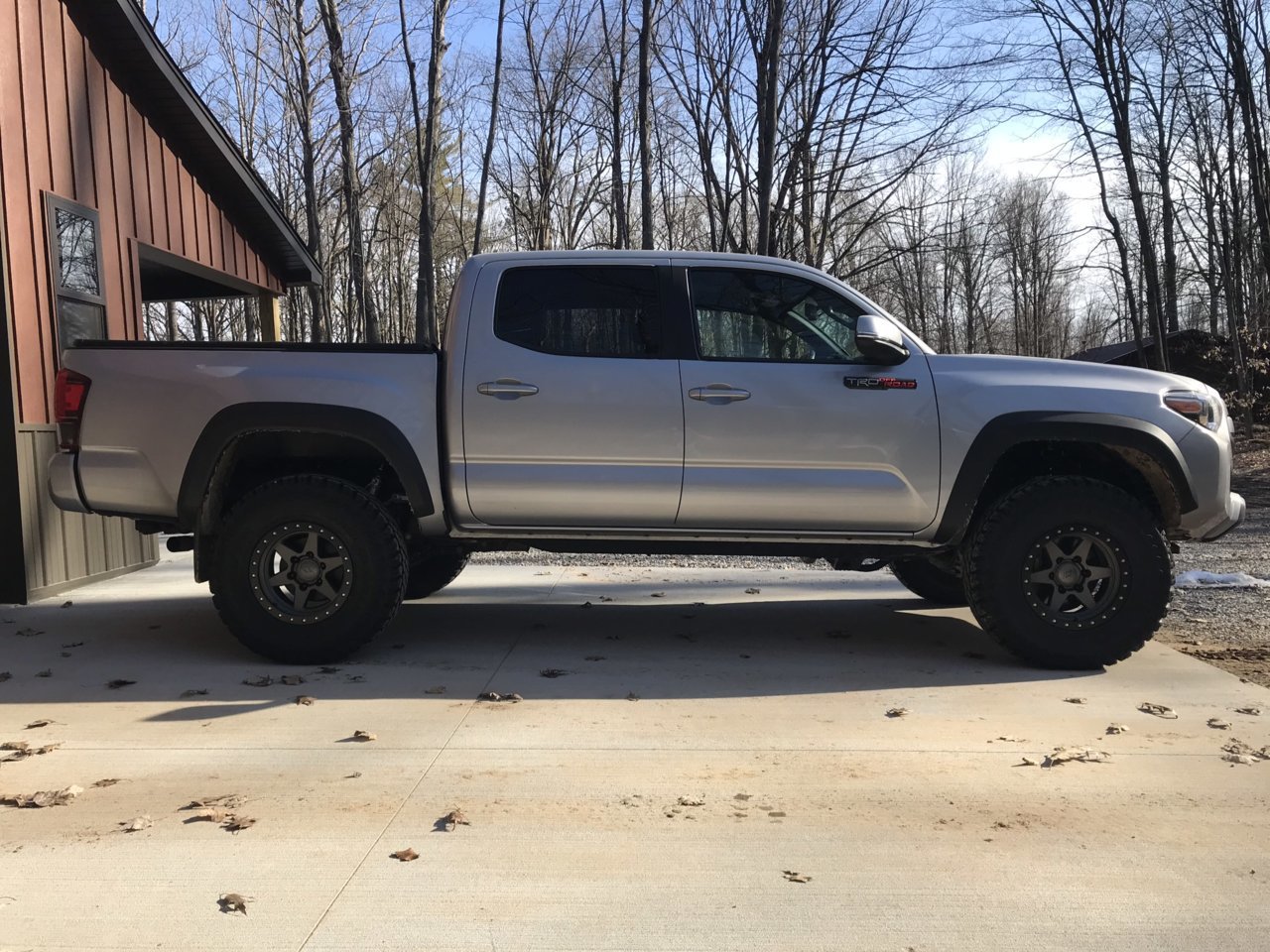

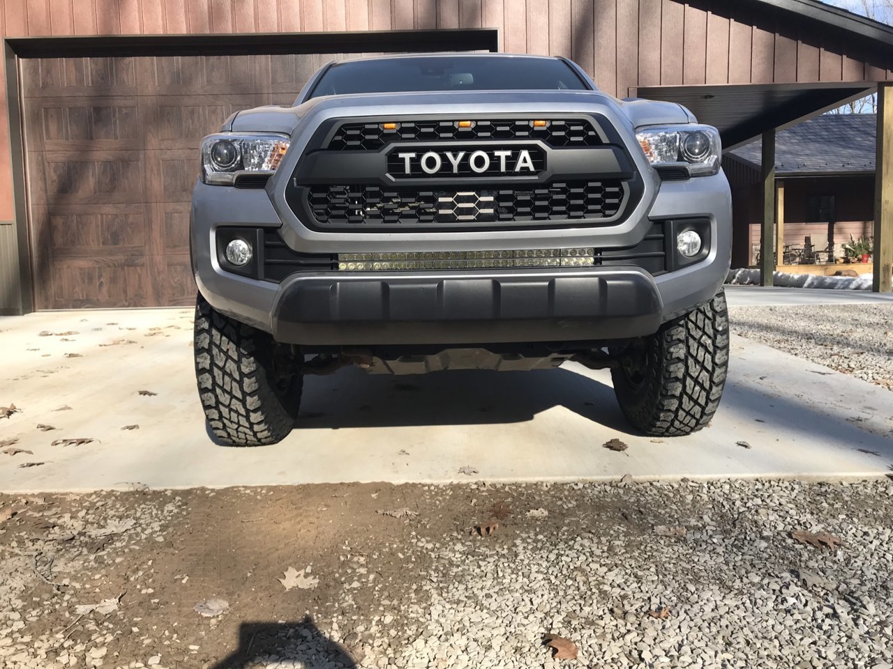

  6. Mar 28, 2020 at 6:12 AM
    #66
    BP1409
    BP1409 New Member
    Jan 19, 2019
    #279794
    4
    Michigan
    2018 Tacoma TRD Off Road Silver
    6112/5160/JBA UCA, 255/85/16’s
    5C75C5AE-3061-40BF-AA9D-2FD8FD6191D2.jpg F4A76ECC-4EA3-442B-BD6D-4BF9398D7993.jpg 4ACE8CD5-6972-460C-92AB-8BC8BEC386CB.jpg 3997B92A-DDD1-40A3-A83A-9508CBEE4C2C.jpg 4ACE8CD5-6972-460C-92AB-8BC8BEC386CB.jpg 6112’s 4/5 setting, 5160’s, JBA UCA’s, Headstrong 3 Leaf all, ECGS bushing, sway bar relocation blocks, SCS BR6’s gunmetal in 16x8”, 4.0” back spacing, -12 offset, 255/85/16 Cooper ST Maxx’s. Waiting for alignment, have some usual rubbing as stated by some and should be able to fix with alignment. 5C75C5AE-3061-40BF-AA9D-2FD8FD6191D2.jpgF4A76ECC-4EA3-442B-BD6D-4BF9398D7993.jpg

    Why'd you upgrade your bump stops?

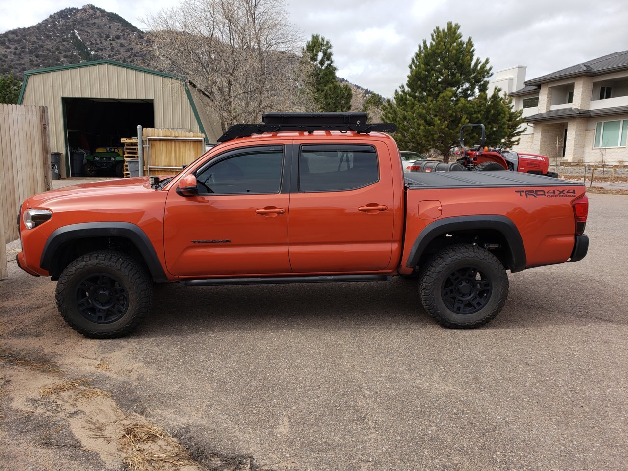

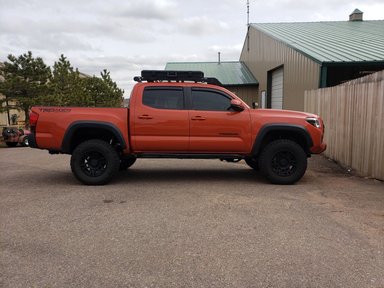

    I gotta similar build. Your 33s still rubbing with 6112 set at 5/4 or 4th notch with 650lb springs? any weights up front? what's your front & rear measurement from middle of the hub to fender?

    I’m looking into doing the exact same setup. Do you happen to have a side profile picture of your truck?

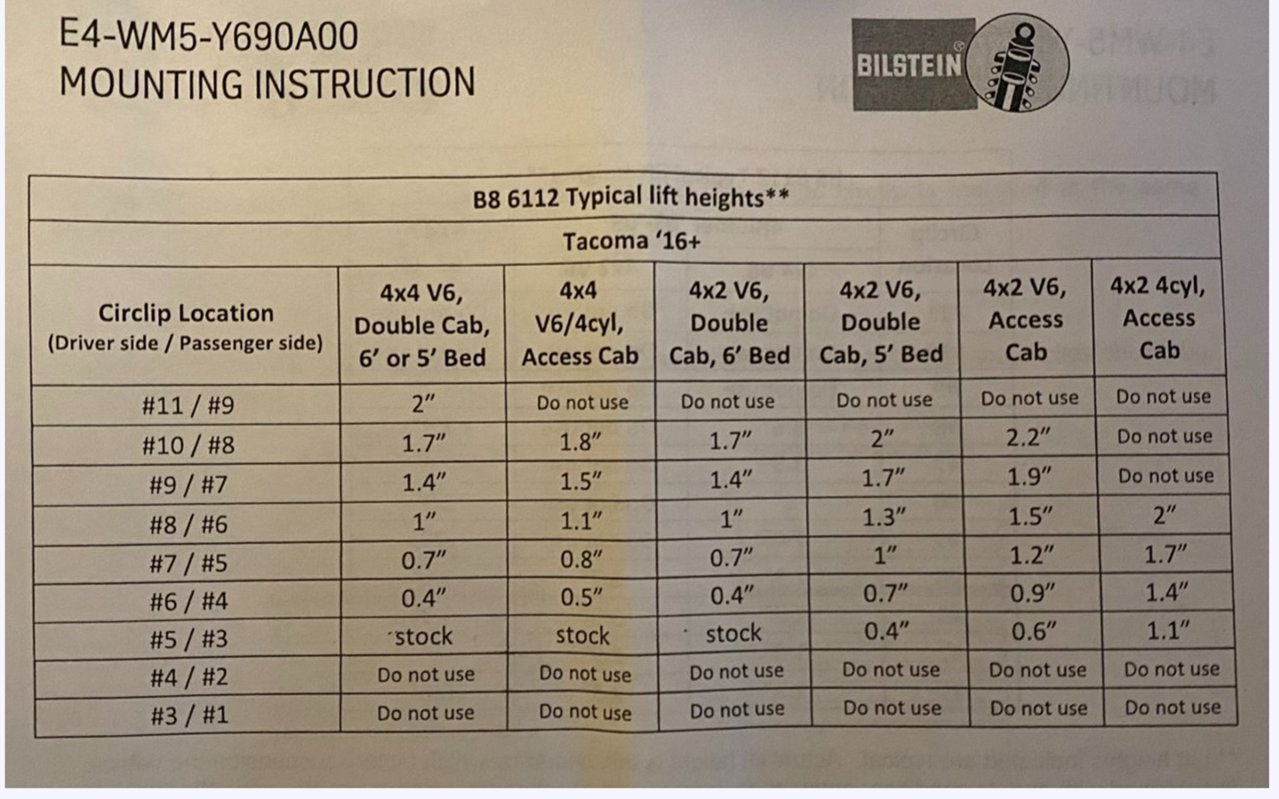

    I ended up getting more than 1 inch at that setting. Roughly 1/2 inch higher in front now. I ordered a 1 inch block for the rear.

    Great looking setups! I have a question for those above with varying 6112 heights. I have CCLB that I'm installing the 6112/5160 combo. I'll also have the Icon AAL and will keep overload spring. I'm not sure if I should go with the 6/5 or the 5/4 up front. I currently have a heavy duty (unsure of make right now) front bumper with Warn winch and I will have an Alu-cab topper, RoofNest RTT, and will occasionally put 2 dirt bikes on a hitch mount rack. I want to keep the rake due to the planned weight on the back. Any opinions on 6/5 or 5/4 - will the 6/5 and the overload + AAL keep enough rake, or should I install as 5/4?

    I don't think they sell the 6-notch version anymore. New one is 11 for more micro adjustments. I've had mine for a year now and at the time Bilstein was shipping a mix of both but I think they are all 11 now. I did 10-8 with the 600 pound springs and only got ~1". Still stumped to this day. I bought the 650# springs and got ~1.5" which was about what I wanted. My front end is stock, no steel bumper/winch, just TRD pro skid plate and Prinsu roof rack.
    For the AAL, when I was researching I did not hear a lot of great things about using an AAL and that they sagged pretty quickly. I did the ICON RXT leaf pack and did option 2. I got 2" in rear so I have a little bit of extra rake which is fine because it levels out when I go camping.
