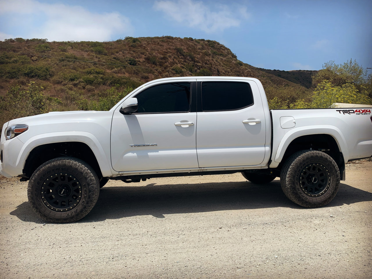

    6/5 settings with Dakar medium leaf pack in back. Tires 265/75/16. 2” lift front and back verified after install.

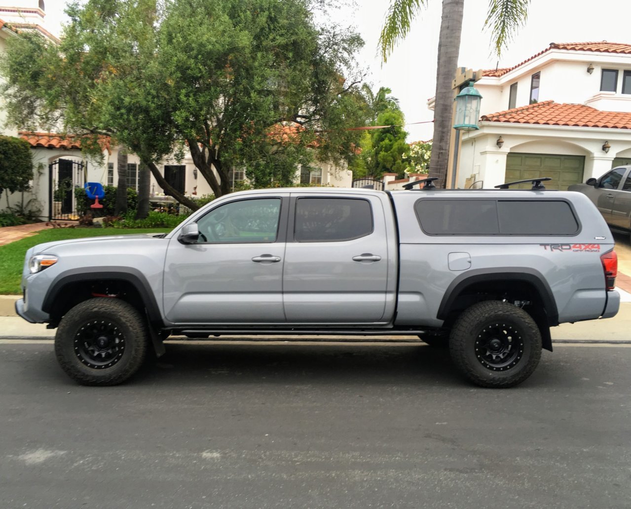

    Kings 2.5” front and rears from Accutune / ICON RXT LEAF PACK black badges doors and tailgate / method 315 / 255/85/16 Yokohama G003 / magnaflow exhaust , axle dump / meso int delete kit / meso led map lights / dome lights / wheelers front super bumps / accutune Flip kit with spacer and new bumps / Cali raised fog light pods / Cali raised ditch lights / RCI FULL SKIDS / SLIDERS / RCI rear bumper / rigid backup lights / tuned on 4.88’s
    Hell Yeah!!

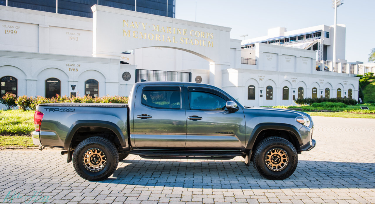

    2240E7EB-C0E5-43A3-A2E2-8D8BC3726D2A.jpg 6/5 lift, tires are 265/70/17 Toyo AT II on method 305s. It rides great just need to do the clamshell bushing

    Thanks! What did you do to the rear?
    TheTacoMarine[QUOTED] likes this.
  12. Aug 14, 2020 at 2:54 PM
    TheTacoMarine
    TheTacoMarine Well-Known Member
    May 31, 2018
    #255046
    367
    2016 Tacoma TRD Sport
    5160 with medium Dakar leafs.
