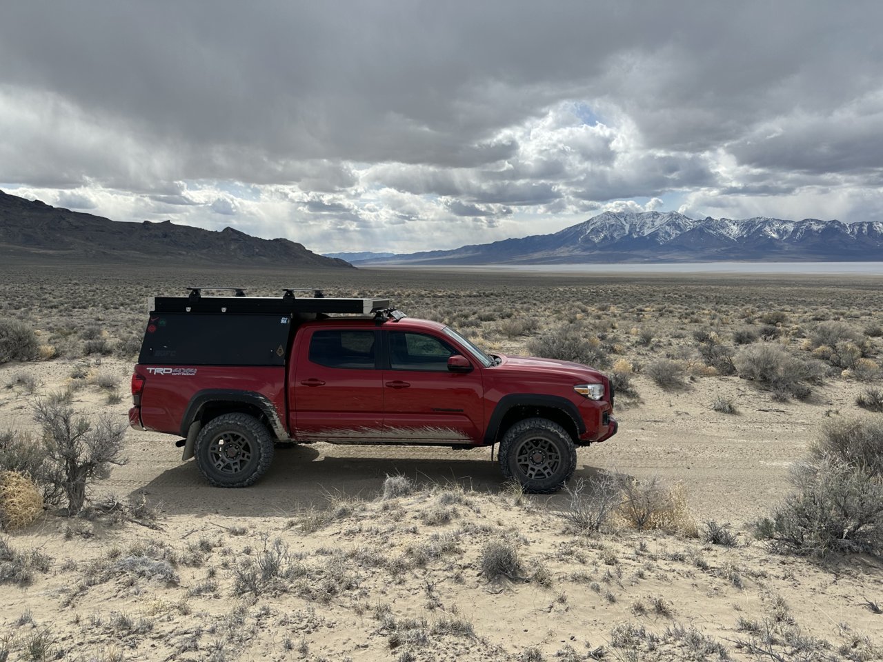

    6113/5160s w/Ikon 3 leaf AAL and Sumo Springs. No rear sag. Rides great. 33” pizza cutters.

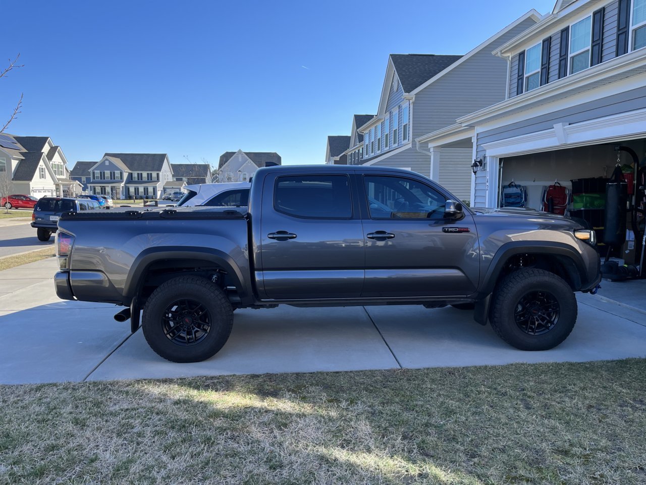

    Been running this set up for a few years now and it's pretty good in my opinion.

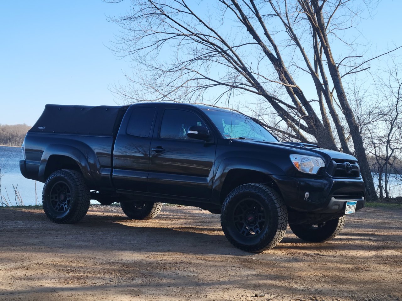

    Have 38K on my Bilstein package and it still performs excellent for my use. Zero complaints and wouldn't hesitate to purchase it again.

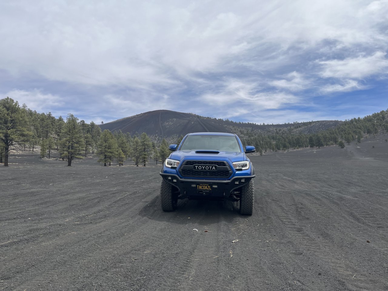

    So finally got my lift installed after having it collect dust all winter. Set them at 11/9 with 650# springs and SPC UCA’s up front. Icon stage 2 in the back. Had them on for a couple weeks now and overall I am very happy. I was a little tentative about going with the top notch but I think the ride is great! Feels more refined and definitely more planted on the highway. I’ve logged a few quick easy off road miles and felt nice out there as well. Definitely firmer but not jarring or anything at low speed.
    Here are my semi exact before and after measurements from hub center to fender after a couple weeks of driving/settle.
    Before After
    DF 20in 23in
    DR 20.75in 23.5in
    PF 20.5in 23in
    PR 21.5in 23.5in
    I’m yet to install my plate bumper but I imagine it’ll drop the front down a bit and hopefully make the ride even nicer.
    I forgot to take a before pick but here’s an after.

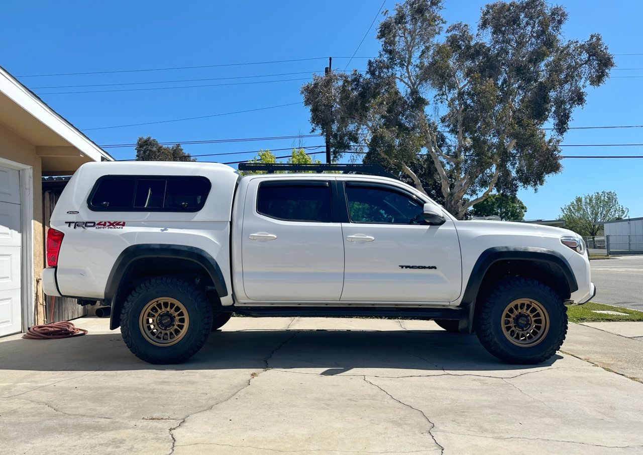

    Bilstein 6112/5160, Icon AAL, CMC, 285 Falken Wildpeaks on SCS Ray 10s
    Here's my 2023 TRD Sport MT
  15. Jul 24, 2023 at 8:39 PM
    #195
    805 Tacoma Tuning
    805 Tacoma Tuning YotaWerx Authorized Tuner | Ventura County, Ca.
    Dec 6, 2019
    #312679
    326
    Tom
    Ventura County
    2020 TRD OFF ROAD DCLB
    Setup looks good, sitting perfect.
