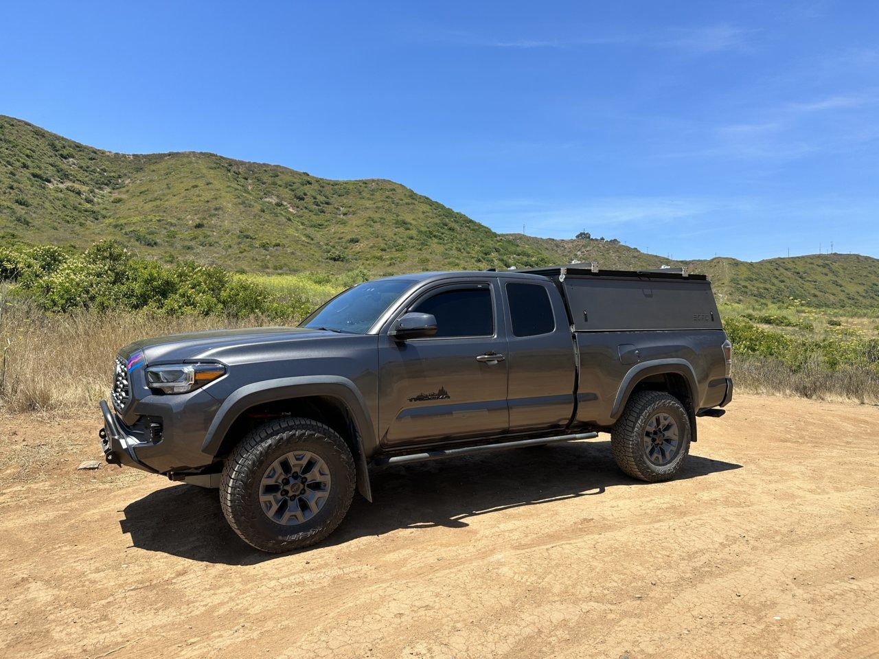

    Had mine installed April 2020 when my truck had 48k on it. It now has 120k and these shocks have held up great so far! There’s some wear on the shock body as expected but overall no issues. Looks like the isolators have some cracks from normal wear/heat, so I’ll probably have to replace those at some point. I shouldn’t have to worry about new shocks anytime soon, hopefully? These are the old style ones with a lot less notches on them (6?).

    Nice topper :thumbsup:

    Couple of questions if it's OK
    Are they hyperdipped stock wheels ? They look really good
    Also are those 265/75R16s KO2s ? They also look good
    Last - is that a mild viper cut to the front bumper ?
    Really nice rig - I'm trying for that look.

    Thanks! It has been one of my favorite upgrades for sure!
    Thanks!
    They are the stock OR wheels, I had them powdercoated. I didn't want to spend more money on new wheels when I liked the stock ones. I just didnt like the chrome and I did try the vinyl to black them out but I am much happier with the powdercoated look.
    The tires are 265/75/16 Falken Wildpeaks.
    And no viper cut, maybe it just looks that way from the angle or from the SSO bumper.
