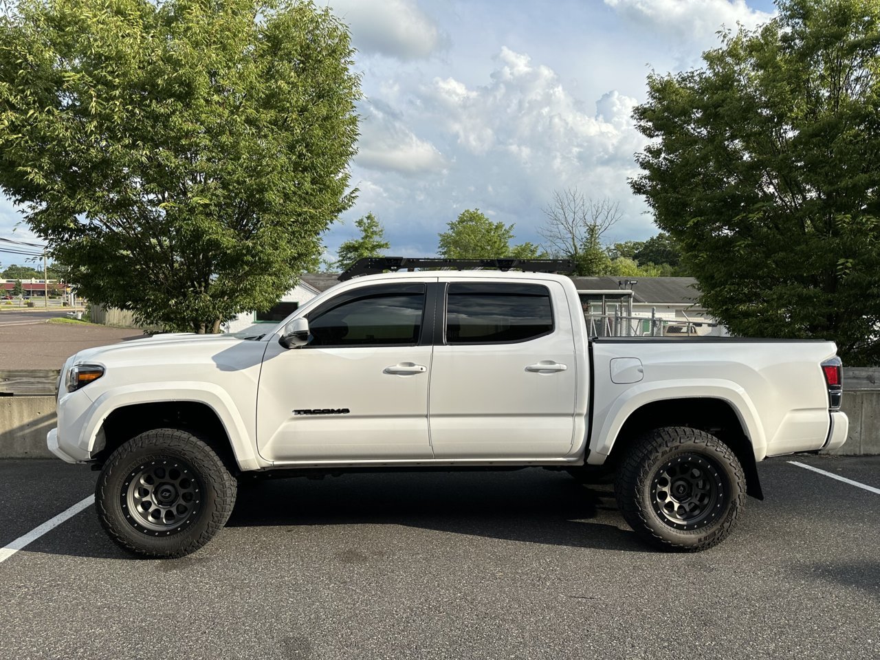

    Set to 6/5 on fronts so full setting

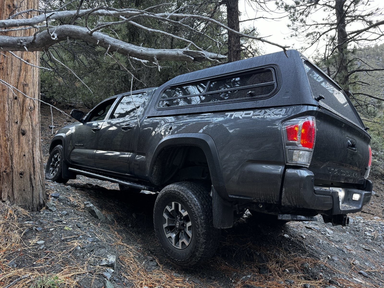

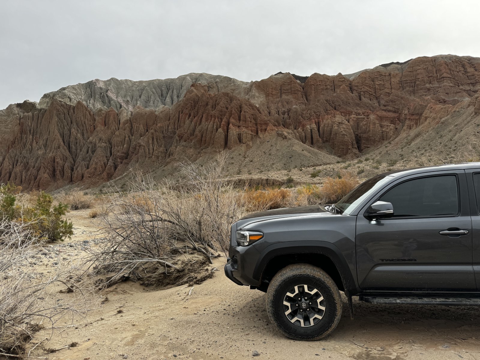

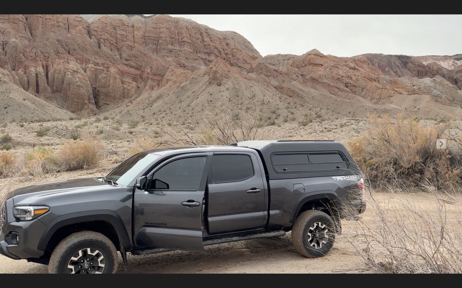

    10/8 with RXT leafs at opt 3 and Timberen bumps front/back. I tried 11/11, 11/10, 11/9, and really like the better ride quality at 10/8. Recently switched to opt 3 from opt 1 and glad i did. I think after some slightly bigger tires or 255's the rake will look less rakey, although close to factory geo was/is my goal. Also just recently added the front timberen bumps in place of factory and wow it made the 6112 come to life and puts them to work smoothly
