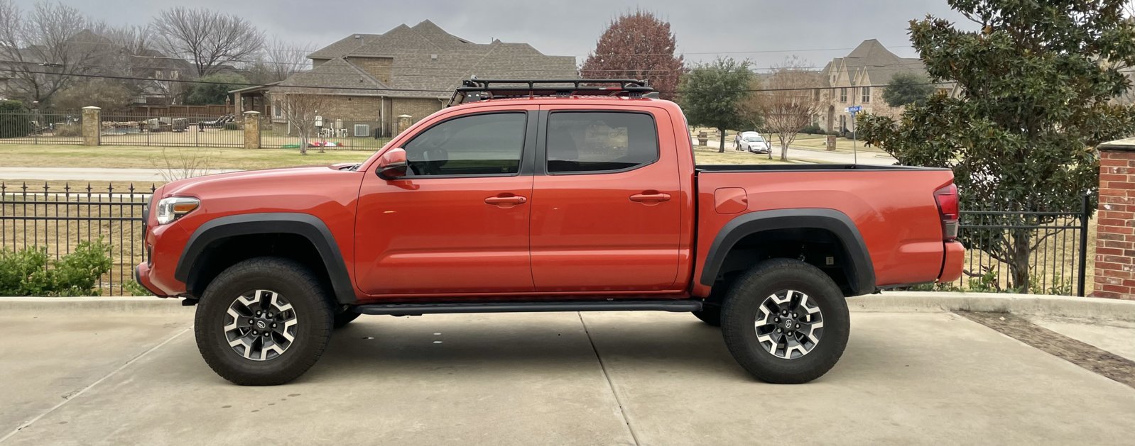

    6112/5160 with Icon RXT on stage 1. Sitting on well used 265/75/16 Toyo AT3. Thinking about the new 255/85/16 wildpeak.

    Look great . What level clip on the front . Btw, post once you have the 255’s installed. Tnx

    I got more lift out of the rear than I’d hoped. I think I’m on 9/10 in the front to balance out and not rake too much.

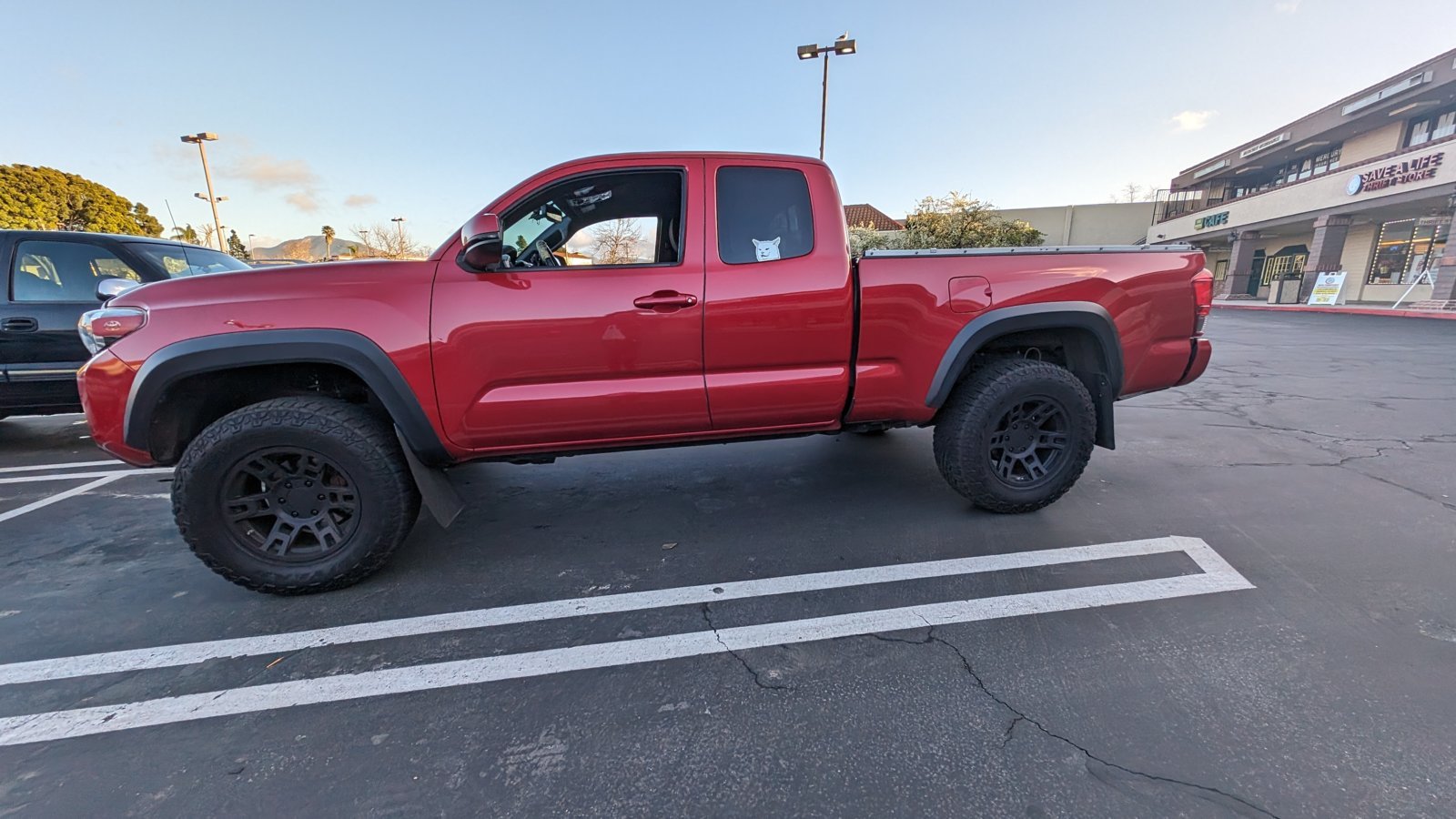

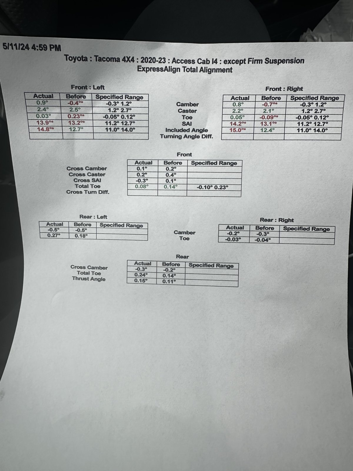

    Installed 6112/5160 and Icon aal with overload spring. Bought them from suspensionlifts.com pre-assembled at 11/9 setting. Didn’t measure before installing and I couldn’t tell if they were in the right settings for the 6112. I did measure overall length of the 6112 and they were around 27” and 26”. I wasn’t expecting the rear to be much higher or maybe the 6112 wasn’t set at the right (11/9) setting maybe. What do you all think? Is this how it’s suppose to look? Also attached my alignment with stock uca.
