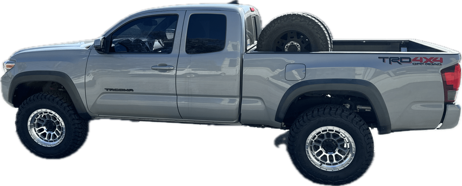

    I have a 3rd gen access cab and swapped out my OEM + aal leaf pack with a stage 1 icon. So much better feeling. gave me some rake, but I like it! Also, still have my Bilstein 5160/6112s. Here’s a pic for reference its with my old packs/tires in the bed but you get the idea.upload_2024-6-24_22-41-44.png

    I have the blue set of bilsteins so I’m on the max for access cabs (4th/5th setting)

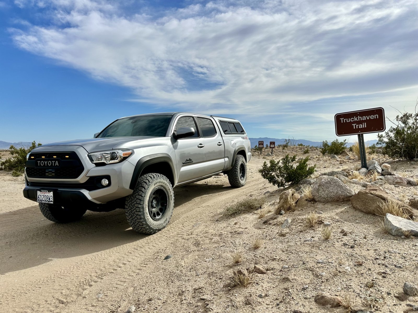

    6112/5160 setup with Icon add a leafs. BFG KO3 tires in 285/70/17. So far so good! I originally wanted the Fox Performance 2.5 setup but just couldn’t justify the price.

    great looking truck! how much trimming did you have to do?

    I kept the stock UCAs so I didn't have to do any trimming. Every once in a while, I do get a very slight rub on the driver's side. But it's nothing that's too bad where I feel like I need to cut it.
