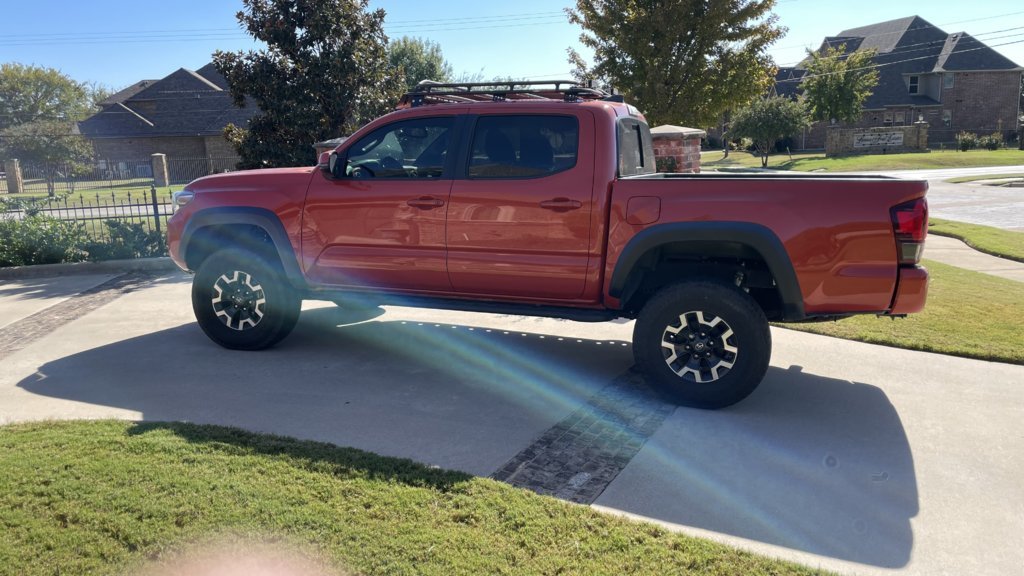

    Well, I can add that the icon RXT on stage 1 got me 2.5+, almost 3” empty bed. But… my stock leafs had about 90k miles on them so there’s that. I really like the ride, but the rake is a little steep, even with 6112’s set fairly high.

    '18 DCSB TRDOR Inferno
    Dirty pig about to get a shower.

    OTT Tune Front 2" lift OME 888 coil Bilstein 5100 DuroBump extended front bump stops Archive Garage extended rear bump stops Rear 1.85" lift Icon RXT leaf pack Bilstein 5100 SPC UCA DX4 16x8 +10 wheels 285/75R16 KO2 viper cut CMC sway bar delete exhaust reroute exhaust cut just past the rear axle U-bolt flip LFD engine skid plate RCI transmission and x-fer case skid plates Spindle gussets
    Are you sure you don't mean option 3

    lol, nope. Extra leafs are still sitting in the garage with my OEM packs. And those are 265/75’s, albeit with only 1 or maybe 2 rotations left in them.

    Whoah, 3" is a lot of lift!
    Truck looks amazing and almost exactly the setup I'm looking at but boy that's higher than the Icon guide

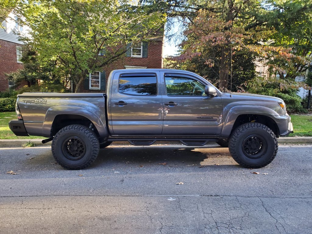

    I did this lift set for 2.5" with the Icon springs at option 3. 285/75r16 KO3s on currently. Had wildpeak A/T4Ws but they caused a radial pull. 2 alignments later then switched tires. Still has some minor issues with random steering wheel wobble (reballanced twice) and a crunch sound going around corners with a bump of some kind but no contact with fender wells that I can see. Getting ready to take it to a different shop.20241020_163019.jpg

    How much lift did you get and are you running stock uca?
