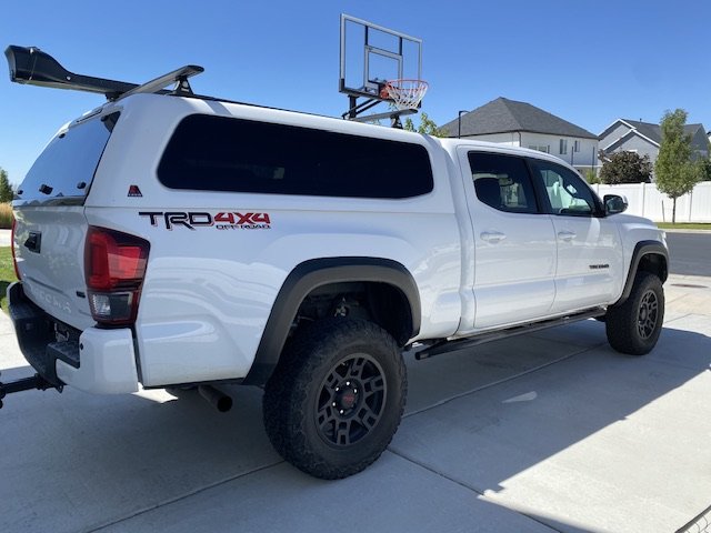

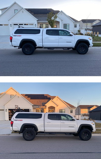

    Here’s mine. 2018 DCLB TRD OR. I have the 6112s set on the highest notch and Icon UCAs. 5160s in the back with Icon AAL. It’s been about a year on this setup and it has been awesome. The only thing is sometimes I pull a small raft trailer, and sometimes with my motorcycle on a hitch carrier too and when it’s all loaded up it sags a bit more than I’d like. So I am wondering if I should add some airbags or just different leaf springs. I wouldn’t mind a bit more rake but I do like the way it rides when I’m not towing.
    Here it is before and after the lift

  2. Nov 10, 2024 at 2:05 PM
    #362
    y2todd
    y2todd Member
    Jul 15, 2015
    #159498
    19
    Are you guys putting new bump stops on with this set up?

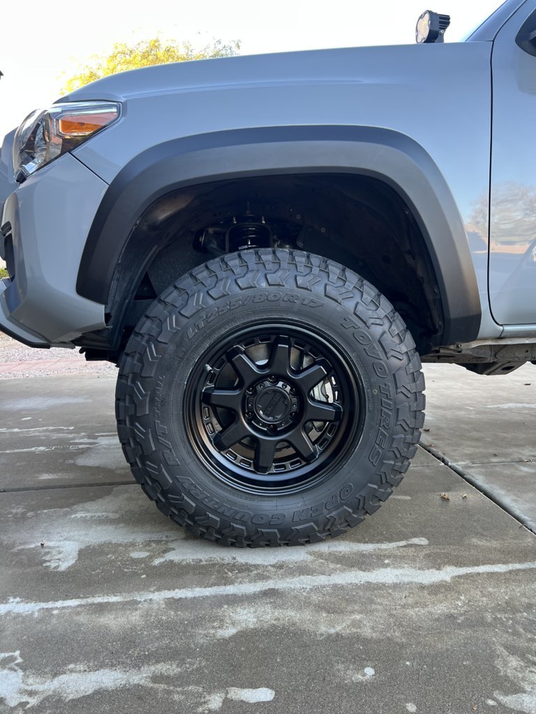

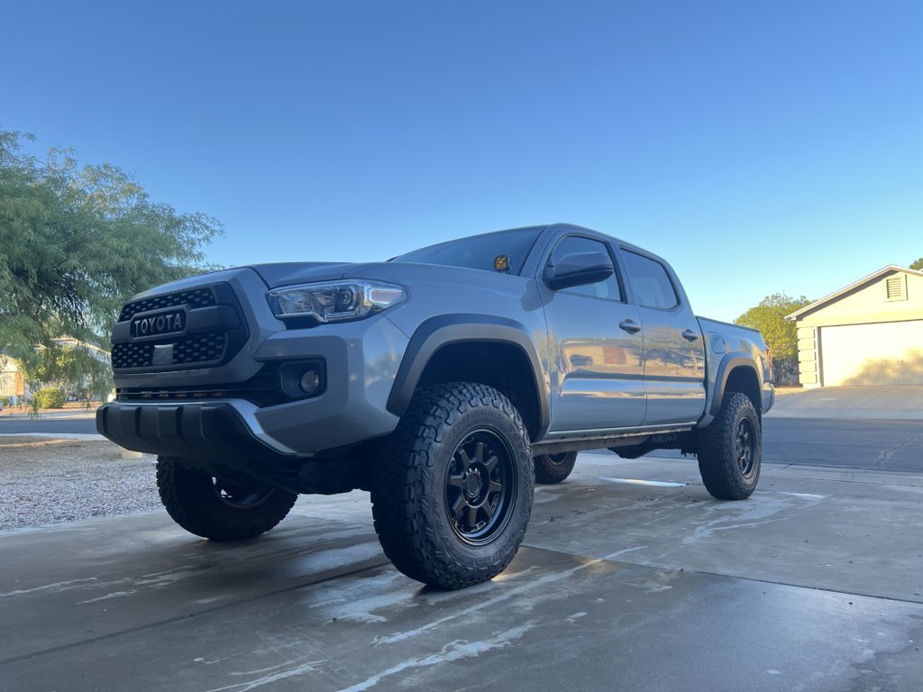

    6112/5160s with some ‘za cutters
    ticyzabna, 4xThad, RIX TUX and 7 others like this.

    I like it, makes me question my 275/70/17 choice.

    Any rubbing that you've noticed? I am considering those same tires.

    stoney1911
    stoney1911 Professional Idiot
    Oct 16, 2023
    #435603
    51
    Phoenix, AZ
    2019 TRD OR DCSB
    No rubbing, but my cab mount is chopped and the pinch weld is beaten. I don’t think it would matter though these tires would have plenty of clearance without those mods done. 0 offset wheels are ideal for this tire size.
