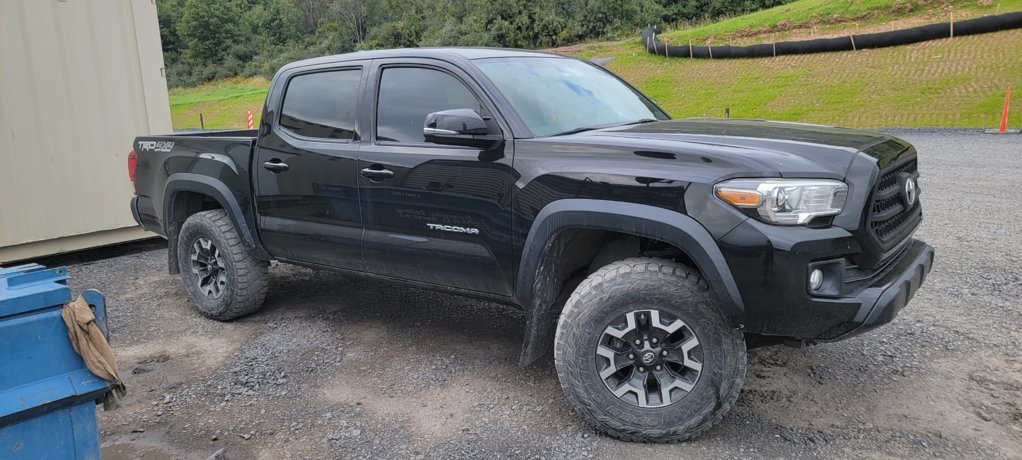

    Shocks installed! Went with 3/2 to get it closer to level, but still close to stock. Found a local garage to do the install because tools and time, came out $200 poorer for it.
    In a couple of days it'll be in for new shoes. Decided against the Falkens, going with Toyo AT3’s in 235/85r16.
