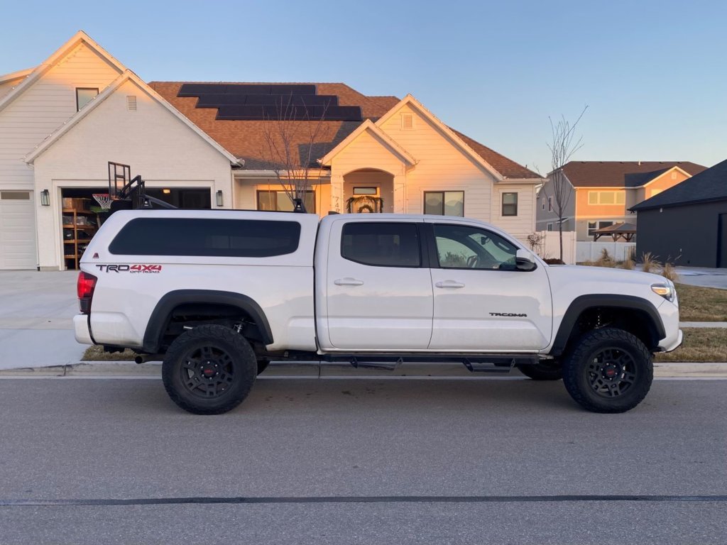

    Sounds like you are set up similarly to me, except I have a LB. Here's my $.02
    1. Shocks alone will not provide any lift so I would look at an AAL or the Icon RXT leaf pack if I were you. I went with the Icon AAL and am pleased with it. I wanted a 2" lift so I have the 6112s set at the highest position and I am pretty level front/back. If the rear starts to sag at all I will probably go with the RXT because I prefer a bit of rake and I tow a small trailer occasionally.
    2. No, I don't think you will need bump stops. I didn't do them on my truck.
    3. I don't think so for that amount of lift. I have my 6112s set on the highest setting (~2" lift) with the Icon AAL in the back and didn't do the extended brake lines. Curious to know what others would recommend here though.
    4. I have both sides set the same and do not have any lean, but some trucks do need it so it kind of just depends on the truck. I don't believe there is anything from the factory that helps compensate for lean.
    5. I don't have any experience with other shocks on my Tacoma but I will say I have been loving the 6112/5160 setup I had installed a year ago. BTW, I also have the Icon UCAs. I love the way the truck rides. Others may be able to give input on other brands.
    Here is a picture of my truck right after the lift was installed. My 265/70/r17s are getting pretty worn so I will probably replace those with either 255/75r17s or 255/80r17s here soon.
