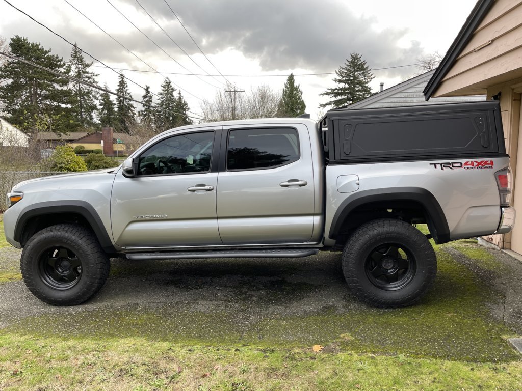

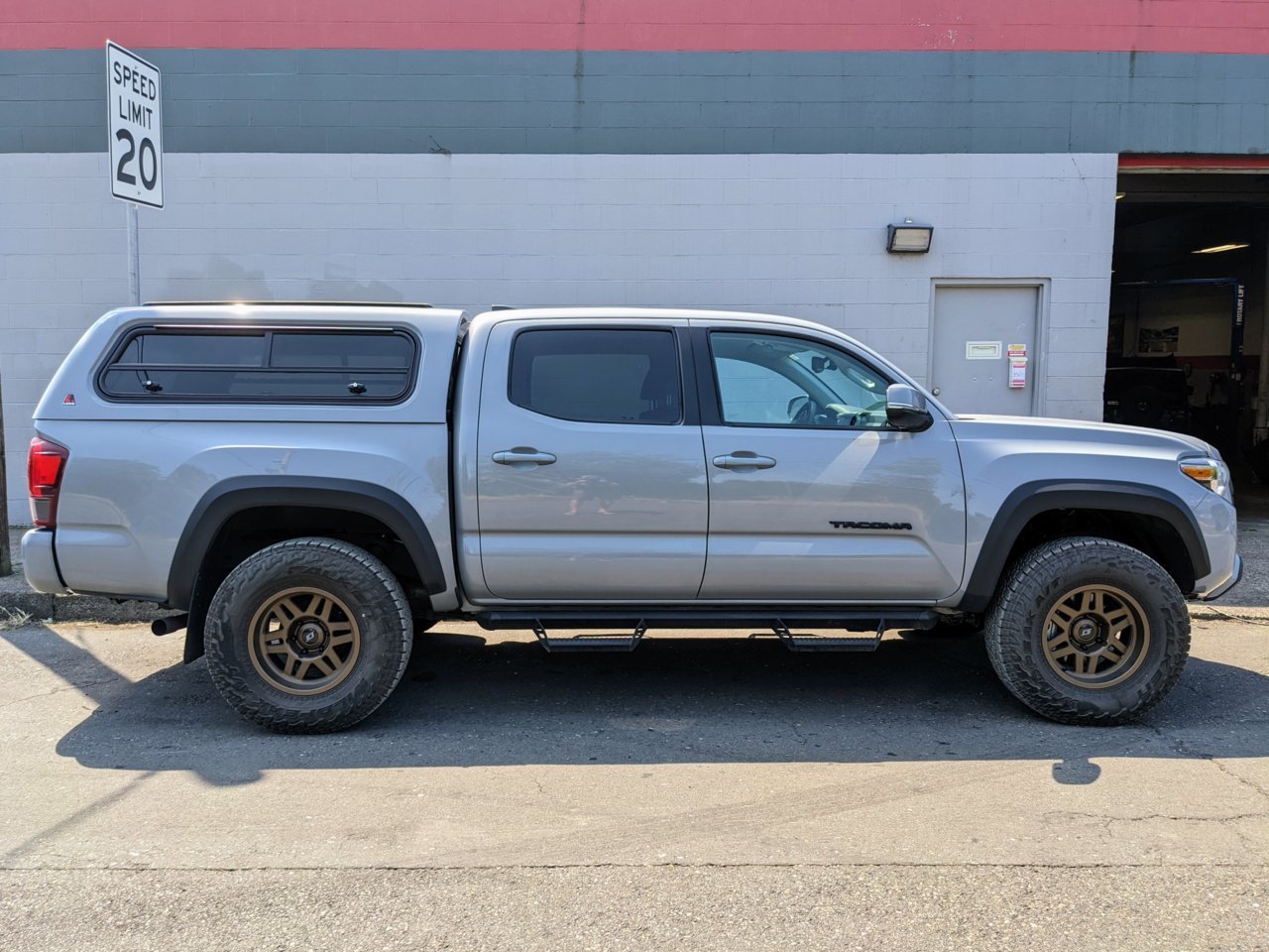

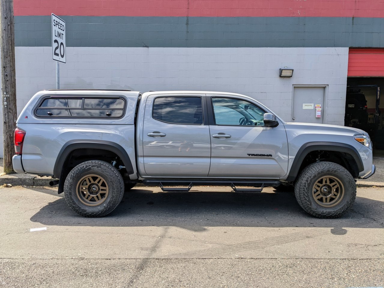

    Here we go, finally got a around to getting a current side pic for reference.
    Slightly raked as I prefer it.
    Currently have 265/70/17 on it, will probably go to 255/80/17 for the next set.

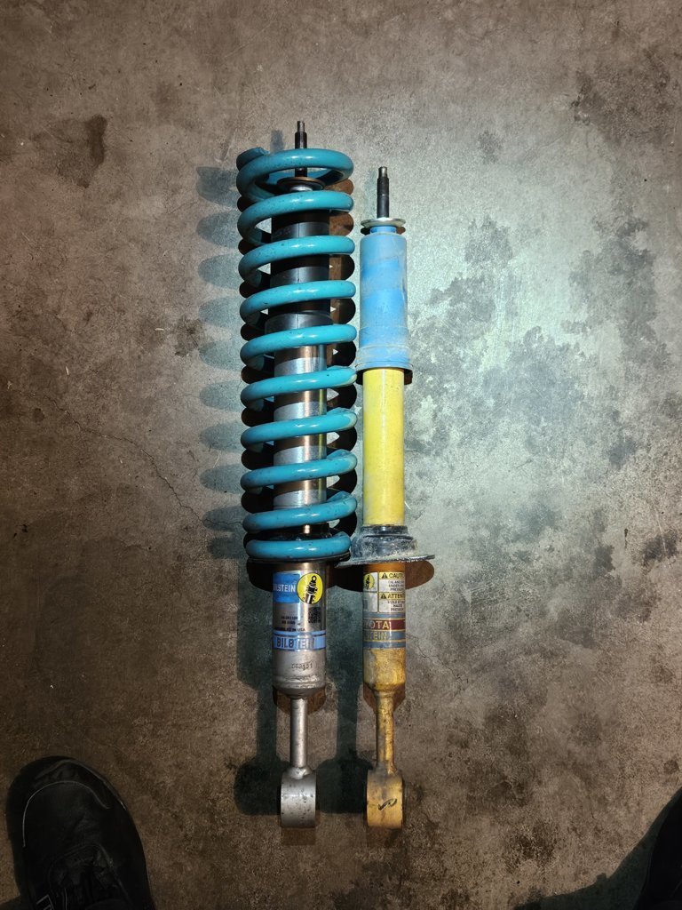

    Thanks memario1214. Wow, I used to think of 6112 as the 60mm version of 5100s. Apparently, they are different builds in more ways. Here is my on the floor pic from Feb. with 5100 and stock OffRoad coilivers.

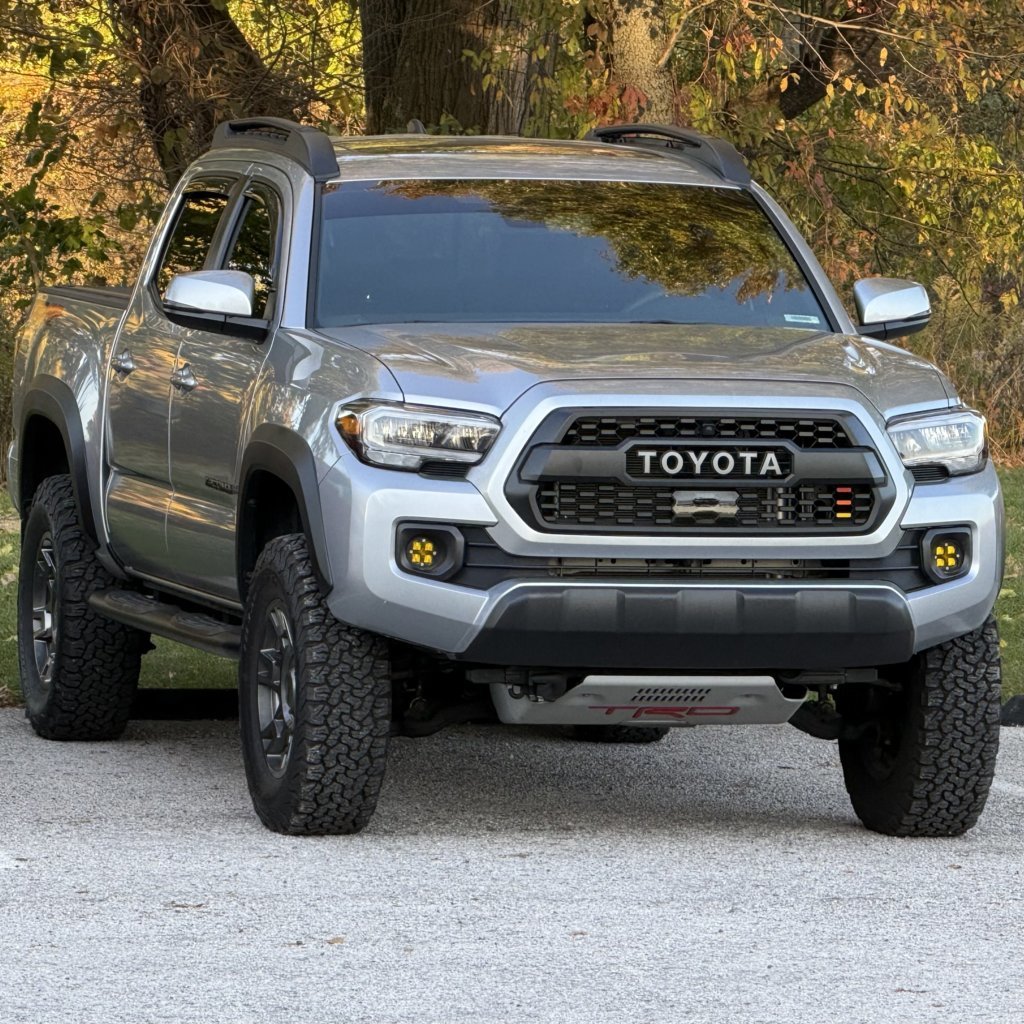

    Just saw this thread! My 6112/5160 setup was installed in Sept of ‘23. Did the ECG Bushing as a preventative measure while installing the 6112’s. Got ~12k miles on it since then with zero issues.
    Also has the ICON AAL with Timbren bump stops and U-bolt flip kit in the rear.
    Opted for the 17” gun metal gray 4Runner SEMA wheels with LT255/75R17 KO2’s

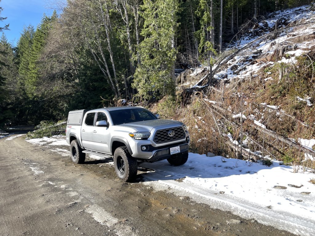

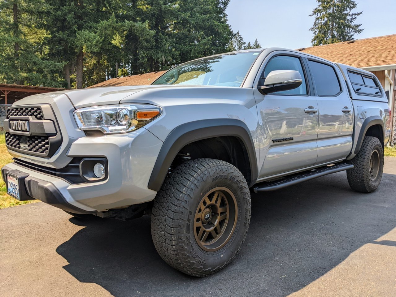

    Here’s mine. Also purchased from Hotshot Off-road. IMG_4561.jpg IMG_4603.jpg IMG_4596.jpg It’s been on a little over a year. This time of year, I am carrying my spare as well as four tubes of sand in the back.
