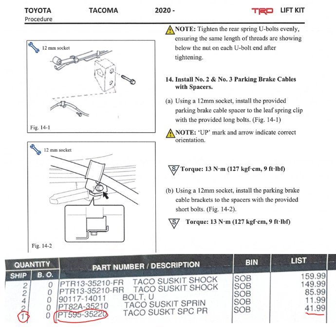

    For the TRD lift kit which uses a 1in block Toyota adds a spacer to lower the e-brake cable where it attaches to the leaf springs. It is probably worth doing.

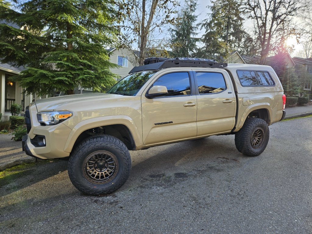

    Bilstein 6112 on 11/9 setting, Bilstein 5160 in the rear with Icon RXT stage 2 leaf springs and Archive Garage bump stops/u-bolt flip kit.

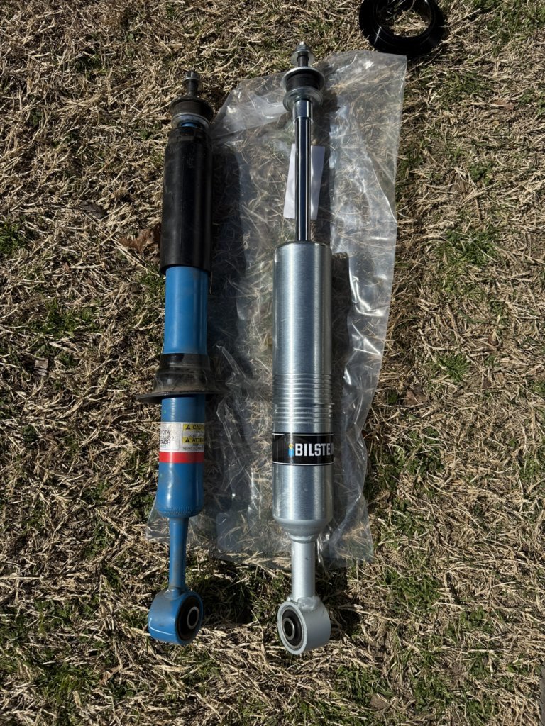

    Thanks memario1214 for answering my endless questions. I went with the clips set at 5/3 to maintain near stock height & correct a slight lean. The rear is same height as stock, the front is now about 1/2” higher.
    I haven’t been offroad yet, but the highway ride is significantly improved. Over many miles of rough and uneven interstate construction the ride is less harsh than the Hitachi’s and much more controlled.
    Here’s a couple pics comparing the Bilstein’s against the stock Sport Hitachi’s.IMG_0316.jpg IMG_0318.jpg

    Here's the P/N for the Spacer for the rear brake line:

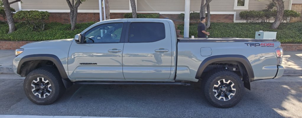

    Thanks! I think so as well…These are set at the 2” lift (#11 on the drivers side, and #9 on the passengers side). Took about a month for them to settle to what you see in the pic, but that’s probably because I wasn’t driving it much. It was a pretty significant amount of settle as well…something like 1/2”!The pic was taken in the fall of ‘24, so it was about a year after install.
    I did remove the front OEM mud flaps, but no rubbing at all otherwise. My only complaint, is that I lost about 2-3 mpg in mileage, but that’s to be expected.
