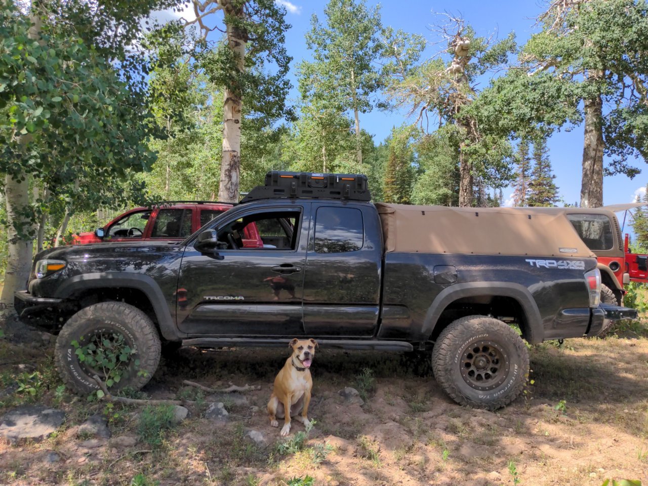

    Fresh and clean:
    More recent photos with all the things bolted on:
