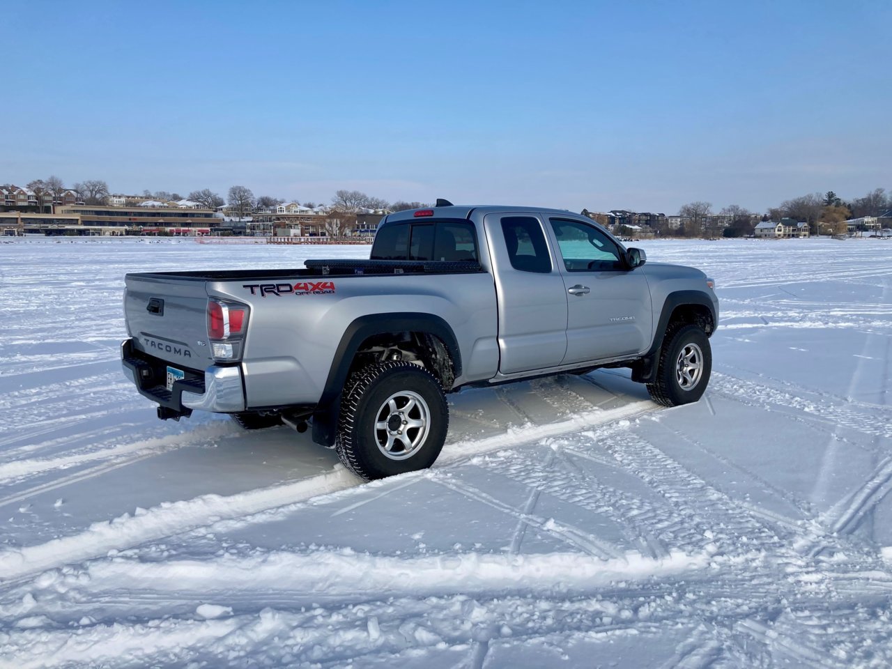

    2021 TRD Off-Road Access Cab
    265/75-16 Michelin Defenders mounted on 16x8 zero offset rims
    basically same overall diameter as 265/70-17 tire

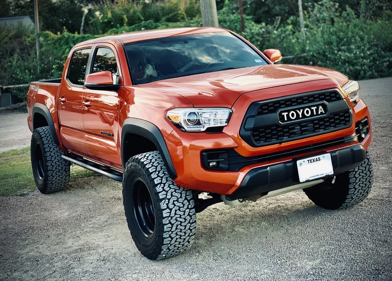

    Front - Bilstein 6112 set at 6, 6. Driver side 1/4 top spacer for lean.
    Rear - Bilstein 5160 with old man emu medium duty leaf packs.
    Wheels / Tires - 16 inch graphite Trd beadlock wheels with BFG KM3 285/75R16. Rubbed on front mud flaps so those are removed fornow and no rubbing. Stock alignment angles.

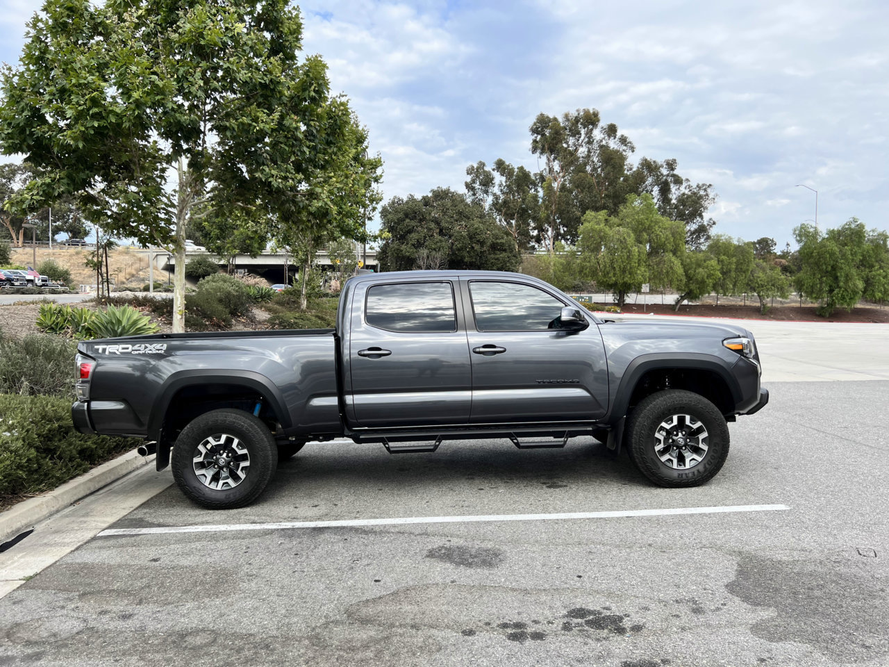

    Here it is with 11/9 up front and RXT leafs opt 1(5160's are in the mail) Total install by myself took 10 hours including breaks and 2 trips to auto zone... I cant believe how smooth and less chattery it is compared to the oem with only 3k miles on em. Even with the sketchy 4130's still out back its way better then stock.
