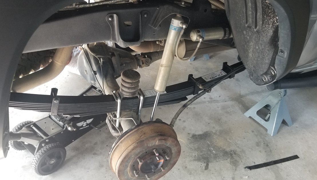

    TRD Off-Road SMS Tacoma
    Bed Rack, Roof Rack

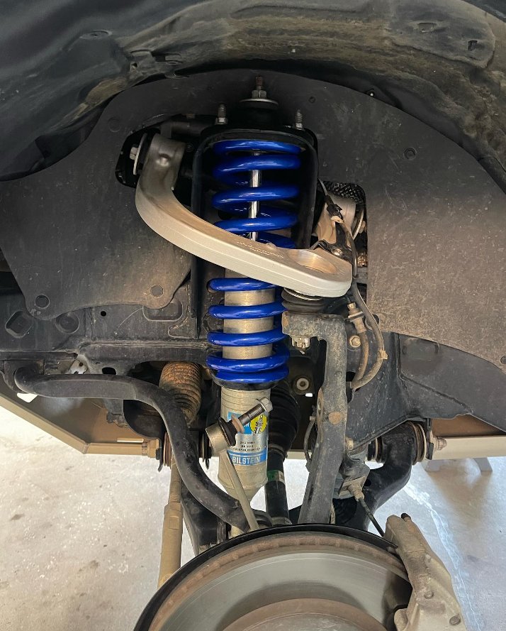

    6112 650# B12 springs 5/4 (powder coated blue). Deaver U402 stage 1 & 5160's. 2" front and rear. Just installed springs for new SSO slimline and winch set to arrive in a week.
    upload_2022-9-27_1-0-18.jpgupload_2022-9-27_0-58-4.jpgupload_2022-9-27_0-55-30.jpgupload_2022-9-27_0-51-23.jpgupload_2022-9-27_0-52-3.jpg
