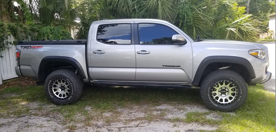

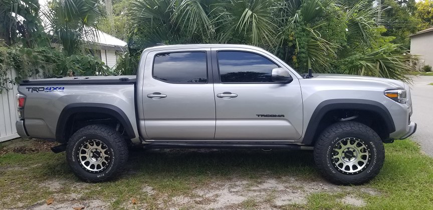

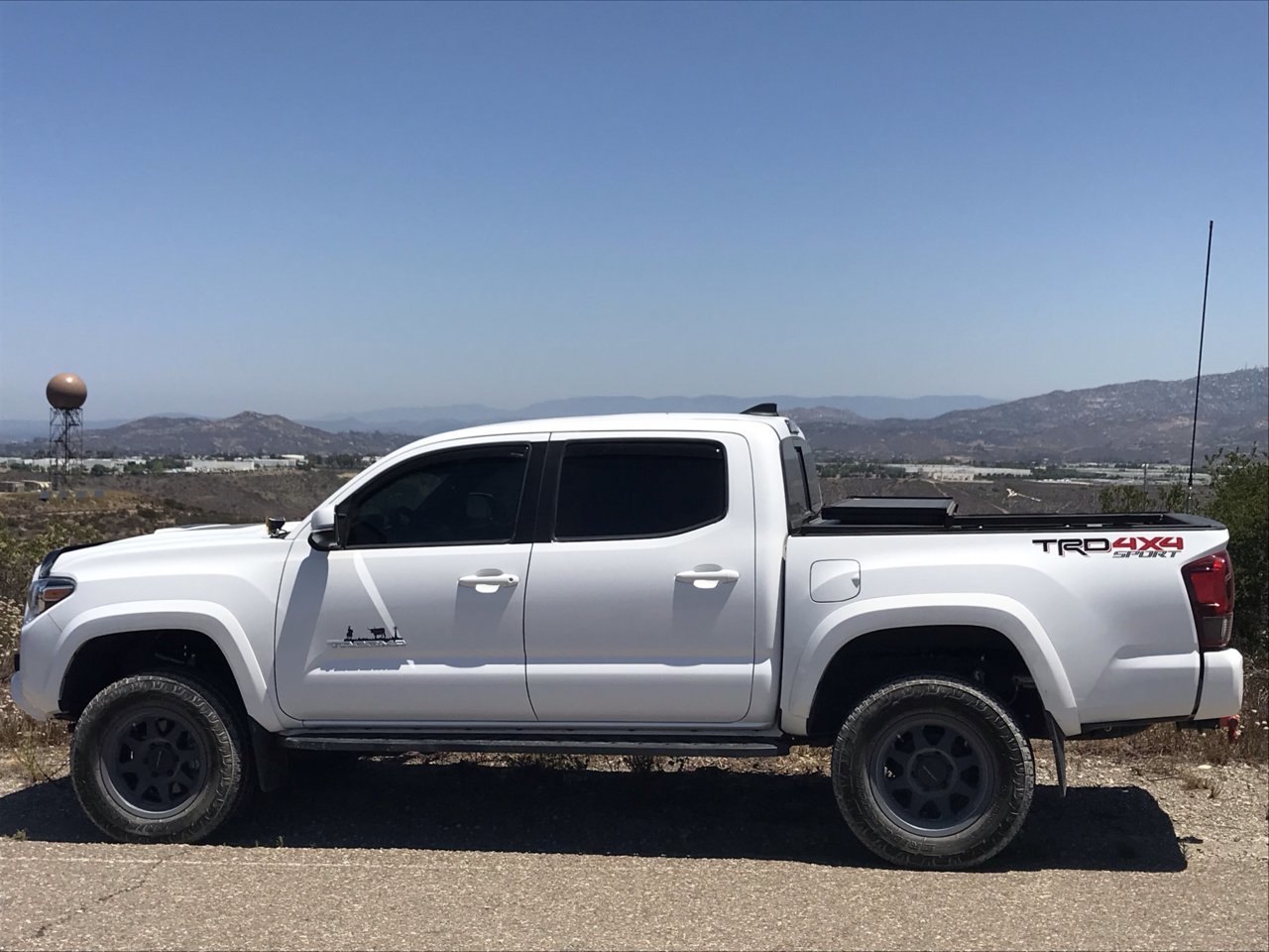

    Comparison photo below in same spot. Hope that helps for reference.
    Deaver leaf pack is closer to 2". At least that is what is advertised. No squeaking with Deaver so far. Only 2k miles to date, but these are pricey and I would not expect squeaking.
    I think you will be fine on 5/4 with 32". It will give you 1.5" of lift and I liked the ride.
    I have since upgraded to 650# springs on 5/4 which is closer to 2" of lift and they are a bit stiffer but I have a bumper and winch coming next week so I would imagine the ride quality improving once weight is added.
    Same with Deaver pack. Empty the ride is good but a little stiff. Once I added my normal bed weight (~ 200#) the ride was much smoother.
    6112/5160 600# springs on 5/4 with HS 3AAL and Ironman 4x4 UCA about 1.5" front and rear
    6112 5/4 650# w/Deaver U402 stage 1 and Ironman 4x4 UCA about 2" front and rear
    MGMDesertTaco likes this.

    I like that look, what size tires are you running?

    265/70 on 17x8.5. Going up to 285 once they are done.

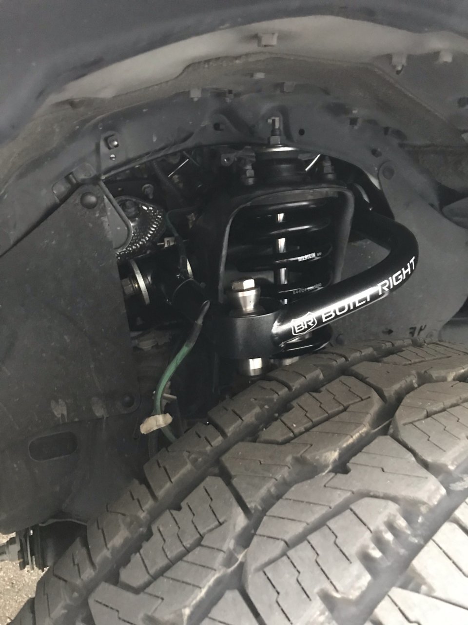

    I was going to go that size but the company I bought my tires from said I could fit 275 no problem so I figured I would trust the source. They weren’t wrong, it does fit with 2” up front and 1” in the rear with zero trimming. However, there is probably a 1/2” gap at most between the top of the tire and the UCA which has me a little on edge.

    Looks awesome! This is pretty much what I’m looking to do. 5/4 with a 3-leaf AAL. What are wheel & tire sizes are you running?

    Thanks! 16x8 -25mm wheels and 265/75 tires.
