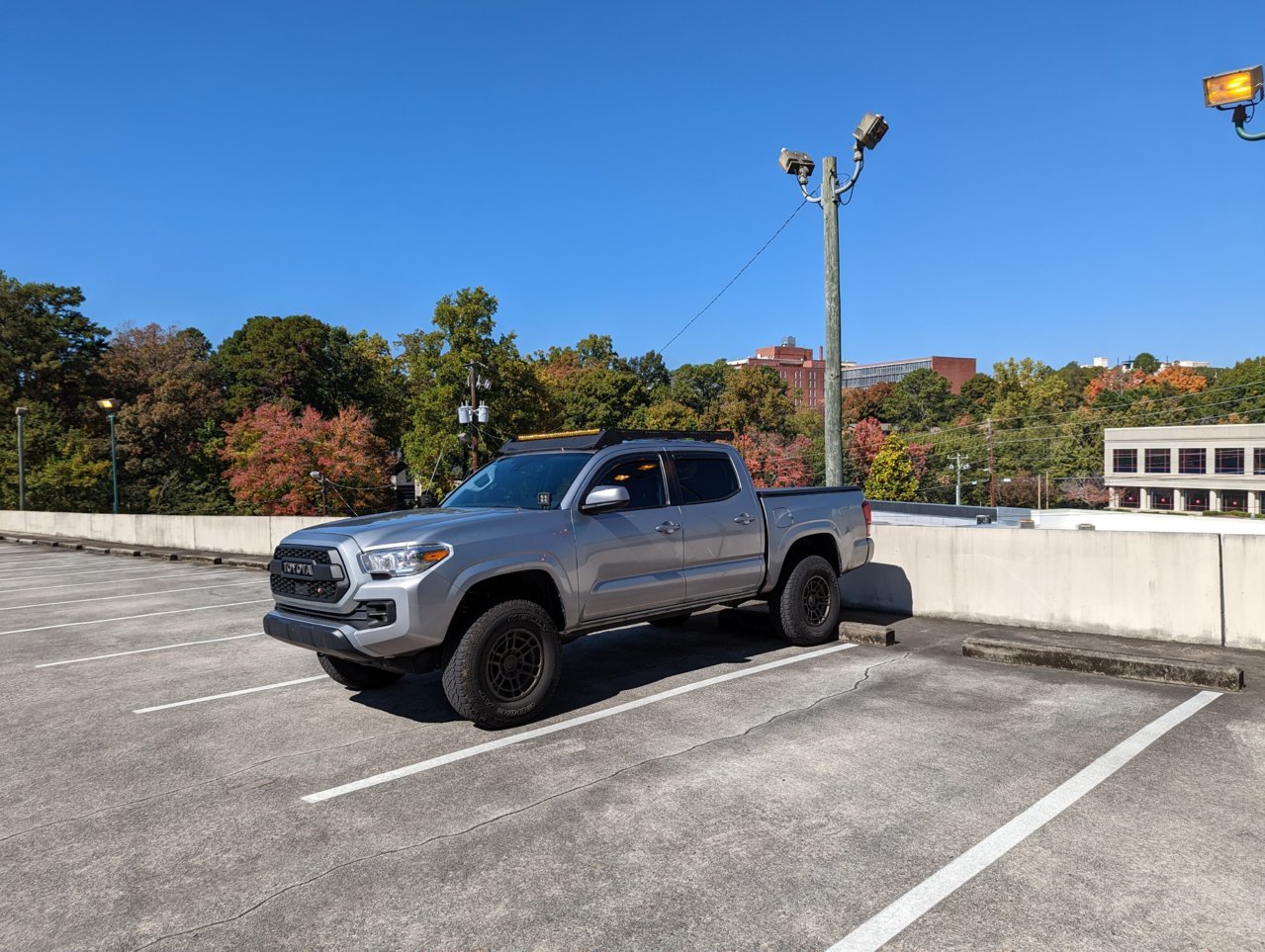

    2019 TACOMA SR V6 SC , 4X4, AUTO, 4.88, 265/75 r16
    265 75. 16 tire. I think I'm close to 1.5" all around

    Is it sitting Level for you? It looks to be in the picture
  15. Apr 30, 2023 at 5:07 AM
    #175
    GSager78
    GSager78 Well-Known Member
    Dec 18, 2018
    #276170
    104
    SoCal
    2021 TRDOR 4x4 DCSB AT, 1978 FJ40
    TRD wheels, 6112s/5160s, 285/70/17 KO2s
    very small rake, but it looks pretty level from some angles for sure. still love the 6112/5160 set up, but I have it on a different tacoma now. perfect for my needs.
