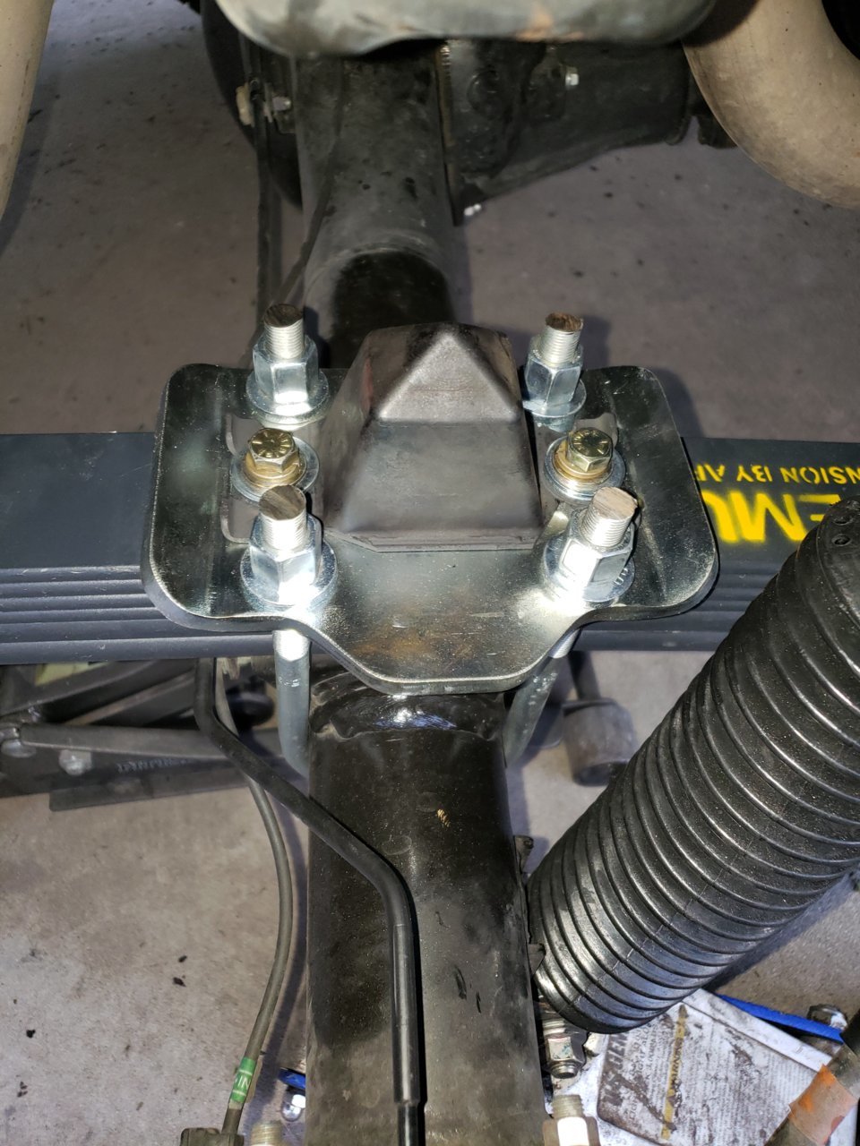

    I have that set up w/ Dakar medium leafs. I had wheelers superbumps and u bolt flip. I was bottoming out too easily. Switched to OEM bump stop. Flexing on them #o's.
