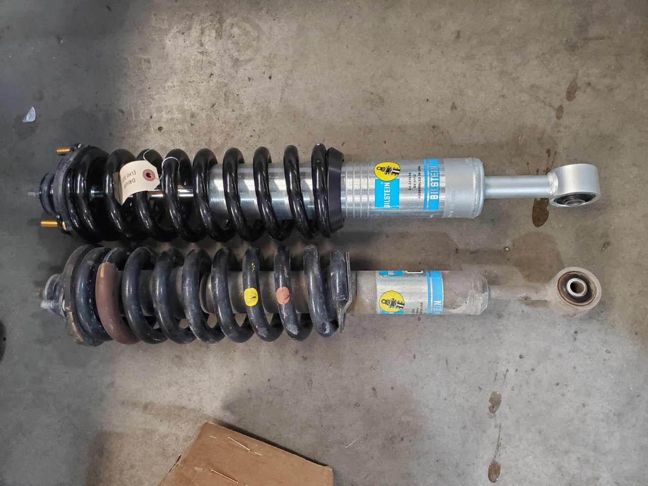

    I had 5100s on my truck when I first got it. Now I have 6112s and 5160s. It feels more stiff/handles better. I dont think I'd change them for anything else unless it was a change for Kings all around.

    Shauniscool123
    Shauniscool123 Well-Known Member
    Sep 22, 2016
    #197976
    204
    Shaun
    Good picture of before and after.
