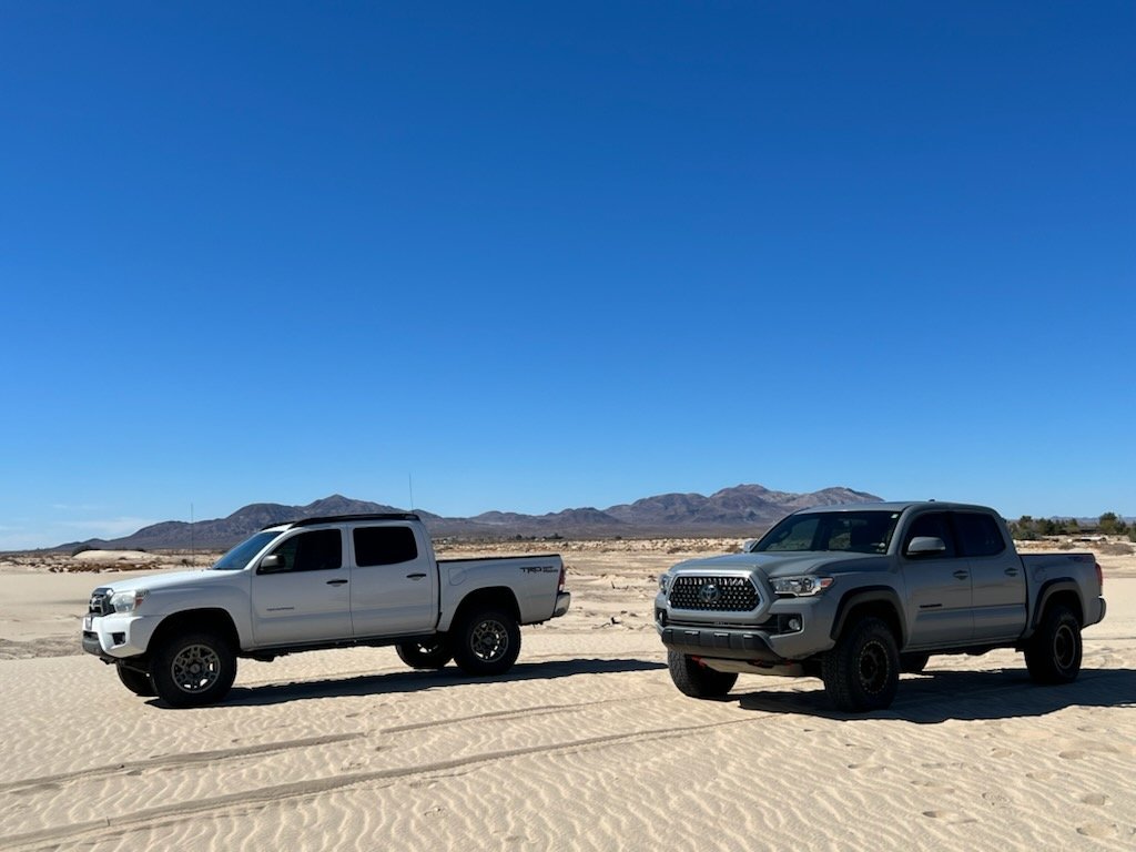

    The 6112/5160 combo can't be beat when it comes to bang for your buck as others have said.
    I have directly compared (same trails)
    Bilstein 6112/5160 (set to 2.5" and 2" lift)
    TRD pro suspension
    ARB OME nitro charger shocks 3" lift
    ARB OME BP-51 set at 2" lift
    The BP-51s ride a little better on road and fast wash board roads but not nearly enough difference to justify the extra $$$ over the Bilstein.
    If you only need 1" of lift a used set of TRD pro shocks would be a great option as well. These ride better than the Bilstein on road and feel the same off road.
    My 6112 set at max height had a jarring "top out" when driving hard off road. Lowering the lift to 2" drastically reduced this as it regained some down travel.
    White taco: OME BP-51 at 2"
    Cement taco: TRD Pro suspension at 1" lift
    Bilstein 6112 at max height (2.5" after settling)
    Rear is wheelers 3 leaf AAL 1.5" lift
